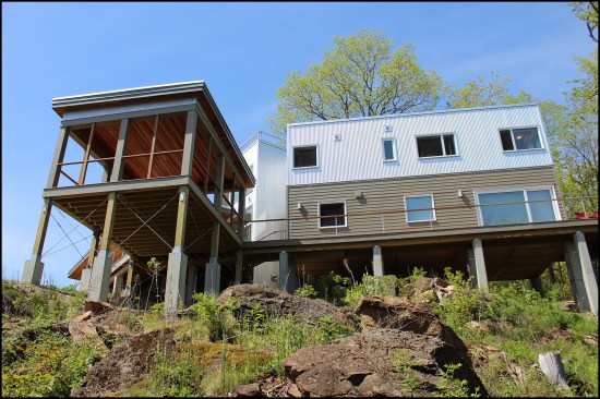

Cutting. Due to the site’s steep topography and the height of the deck off grade, we set up our cutting station on level ground at the north-facing front of the house. Unfortunately, this was a long hike back and forth through the length of the house for our cut guy, which added time to the job. Immediately after the decking was sawn and prior to lugging it to the install area, we sealed the cut ends of the ipe with Ipe Seal (deckwise.com).

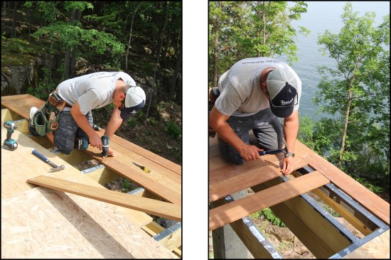

Fastening. We face-fastened the ipe to the framing with 2 1/2-inch-long stainless steel coated trim screws (fastenmaster.com), which were color matched to the ipe. After running a perimeter band of decking, we started applying the field boards, working from the outer edge towards the house (Figures 6, 7).

Figure 6b. The decking was predrilled for stainless steel trim screws (left). A couple of 8d nails helped uniformly gap the boards (right).

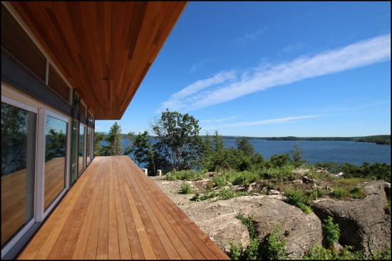

Figure 7. The south elevation was 80% glass. Large high-performance European-style lift-and-slide glass doors set in a steel moment frame (left exposed as an architectural feature) opened onto the ipe deck.
Because of the visible fastener pattern, we predrilled holes and carefully aligned them using a layout square, placing two screws at each joist. To uniformly gap the 1×6 boards, we temporarily tacked a couple of 8d nails into the framing at each course, then set the deck screws with an impact driver. Then we removed the temporary spacer nails, repeating the process until we reached the exterior wall.

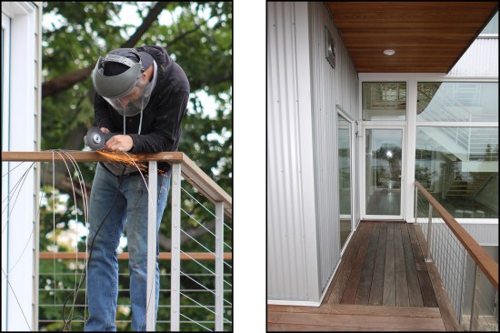

Guardrails. One of the last tasks of the project was to install guardrails on the two deck sections. Like most people who have invested in homes with spectacular views, our clients wanted their views, of Lake Champlain, to be as unobstructed as possible. They didn’t want to sit in their chairs—whether on the deck or on the inside—staring at a railing and an array of balusters. So, we installed a custom-built guardrail system with stainless steel posts and cable railing.
We used 1-1/2-inch-thick ipe stock for the cap rail, which we dadoed to fit over a stainless steel subrail. Local town code allows for 36-inch-high guardrails, which helped keep the rail out of view lines. The posts were set with stainless steel lag bolts set into solid framing (Figure 8).

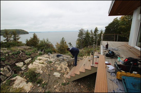

Because we ended up building the pavilion and middle portion of the deck connecting the two decks a year and a half after the house was completed, we needed to reconfigure the guardrails and change the orientation of the decking in some locations to avoid a patchwork look. We reused as much of the expansive rail system as we could but had to install a few new sections. Last, we pressure-washed the older decking, which brought a lot of the color back, then sealed it to match the new. There was slight difference between the two, but I think the ipe is going to weather evenly over time. You can see aerial views of the finished project by clicking on the video below.
