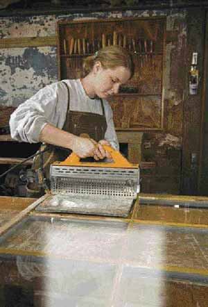

I use the Speedheater to soften up the glazing at the same time as the paint. To protect the glass from rapid temperature swings (which could cause cracking), I cover it with a scrap of hardboard wrapped in aluminum foil. After exposing one 14-inch section to the heat for about 60 to 90 seconds, I slide the unit down the rail and scrape away the loosened paint and glazing compound. To remove the glazing compound without damaging the glass, I use an Eco-Strip chisel with an attached wheel that serves as a depth stop.
