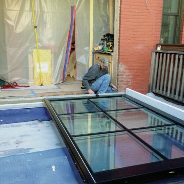

Because we needed to carry the door through two doorways with limited height clearance, Zola shipped it knocked down, but the unit had been assembled and tested at the factory. This is standard practice, because it would be impractical to lift a really large door into place fully assembled—the lift-slide model we were installing can be fabricated up to 26 feet long. Although the jamb can be installed first and panels set in place, we thought it would be easier to put the heavy panels together working flat on the deck. At about 9 feet square and 900 pounds, the door was still within the limits of what we believed we could lift into place.

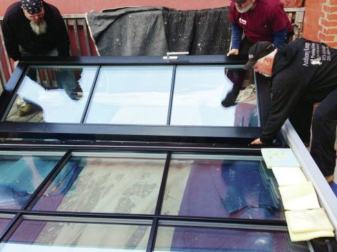

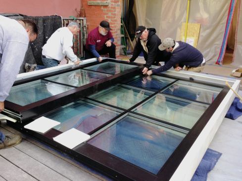

The first step was to put the frame together. This time I hired four boiler technicians to help with the assembly. We laid two rows of doubled 2-bys on the deck parallel to the brick wall and more or less centered in front of the opening. Even though the door was shipped with protective tape covering the aluminum cladding, for extra protection we covered the lumber with thick movers blankets, then laid the larger fixed panel down, roughly aligning it with the opening. This panel had been shipped with the jamb still attached, so the next step was to add the other jamb and attach the sill to the jambs through the bottom using screws provided by Zola.
That was the easy part. Placing the active panel was a little trickier, partly because it weighed about 300 pounds and we had to carefully lower it straight down over the frame while standing awkwardly around the frame, and partly because the concealed wheels and seals had to be properly aligned with the track in the sill and also with the stile of the fixed panel. After we shimmed the frame to ensure that it was as flat as possible, it was a five-man job to get the panel into its proper position. We used a couple of pieces of foam to cushion the doors, and prepared for the worst. It took some coordination (and maybe a bit of luck), but the door found the track easily. We locked it into position, then aligned the headpiece with the wheels and seals of the active panel and fastened it through the top into the jambs.

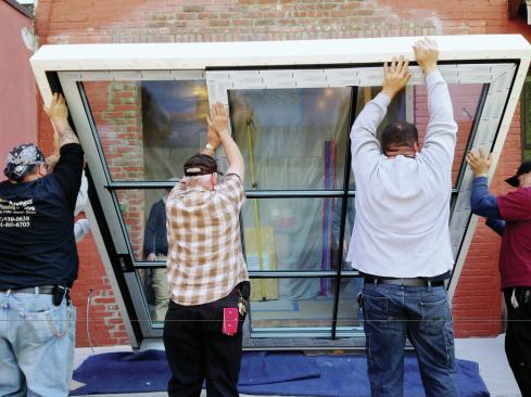

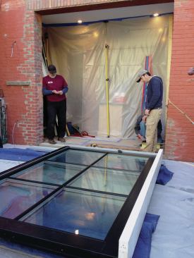

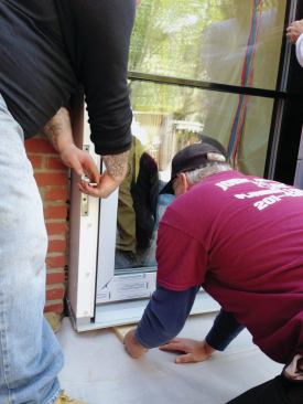

The last step in our plan was to lift and stand the door onto wood blocks positioned in front of the opening, then slide it inch by inch into the opening. It took seven men—two positioned inside, just in case, and five outside—to lift the door and stand it up. (The photo seems to show four, but the pair of arms under the guy on the left belong to me.) Getting it waist high was easy—getting it from there to above our shoulders was the real test. But it turns out we had more than enough muscle to stand it up without any one person having to strain himself. The door was solid and didn’t rack at all.

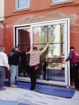

We had dimensioned the rough opening so as to leave 1/2-inch clearance all around the door. That meant we couldn’t tilt it into the opening—it had to go in upright. I had anticipated that this might not be easy, so I brought along four pairs of heavy-gauge 6-inch angle irons, which came in handy. After several short lift-and-slide maneuvers to get the door partly into the opening, we fastened two angle irons back-to-back on each jamb, inside and out. That gave us something to grab onto so we could lift the door and inch it fully into the opening. Before we started moving the door into the opening, we squeezed most of a tube of silicone onto the bottom of the door’s aluminum threshold, incrementally adding more caulk to the masonry threshold as we slid the door into place.
We checked the door for square and level, then fastened it with wood screws on one side and Tapcons on the other. We countersunk the screws into the jambs and finished them later with plugs and paint. To close up the gap on the outside, Zola provides aluminum strips that snap onto the jamb. We applied a bead of caulk in the gap before installing them.

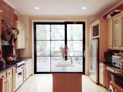

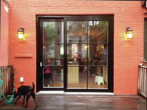

The project was not inexpensive: The door cost about $12,000 (which the owner paid for directly, along with the architect’s fee), and my part of the work ran about $21,000. But as you can see from the photos, the dramatic difference the door made to the appearance of the house, and the additional light it provides in the kitchen, as well as the improved thermal performance and access to the back deck, made it more than worthwhile for the owners and their family (and their pets).
