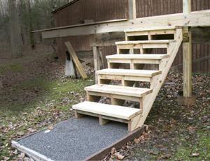

If you are looking for straightforward instructions, in a piece from Professional Deck Builder, “Building and Installing Deck Stairs,” veteran deck builder Mike Guertin writes about how you can build a solid staircase using traditional cut stringers and new hardware. Guertin first establishes a landing area where the deck stairs will come in contact with the ground. He then lays out and cuts the stringers using #1 grade or hand-selected 2x12s.
Treat all cut ends, attach the stringers to the deck, then add the treads. Voila—you’re done.
