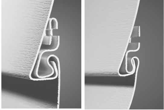

Panel Stiffness
Vinyl thickness varies from about .035 in. (the minimum thickness allowed to comply with the ASTM D3679 standard) to .055 in. While thicker panels are less likely to droop and wave in hot weather, they are not necessarily the best choice, as overlaps between panel lengths are more noticeable with thicker panels. Most installers prefer a “midrange” panel thickness of .042 to .044 in.

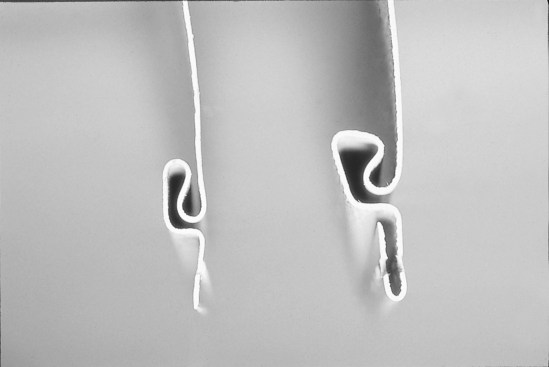

The stiffness of panels depends much more on the shape of the panel than on the thickness of the vinyl. The thicker the butt at the locking edge, the stiffer the panel will be and the less likely it will be to droop or wave (below).
The stiffness of a vinyl panel is more affected by the butt dimension and the lock profile than by the gauge of the vinyl. A square butt (near right) will stay straighter and droop less than a post-formed edge (far right).

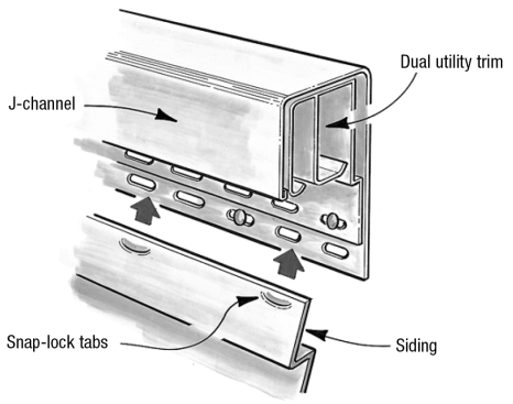

Notched wall panels, which have the nail hem ripped off, can be locked in place with dual utility trim (Dual Utility Trim, below).
Use dual utility trim to secure notched panels without a nail hem. Use the outer channel for siding panels ripped near to the butt edge; use the inner channel when the rip is made closer to the nail hem.

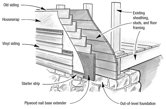

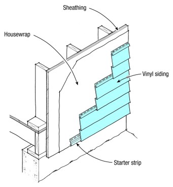

  • Start the layout with a level starter strip. If the foundation is out of level, extend the nailing base as shown in the figure Starting Out Level, below.

Siding should be installed level. When foundations are out of level, extend the nail base with a piece of plywood that matches the thickness of existing siding.

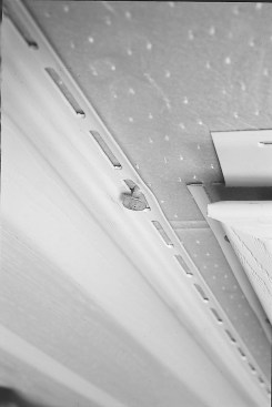

Nailing Checklist
Do not drive nails home when installing vinyl siding. Vinyl siding needs to be able to slide back and forth as it expands and contracts with changes in temperature.
  • Nail heads should be a minimum 5/16-in. in diameter, and the shank should be 1/8 in. in diameter. All fasteners must be able to penetrate at least 3/4 in. into framing or furring.
  • Space nails to hold accessories such as starter strip, J-channel, and utility trim every 8- to 10-in.
  • Space siding panel fasteners a maximum of 16 in. apart for the horizontal siding panels, and every 12 in. for vertical panels.

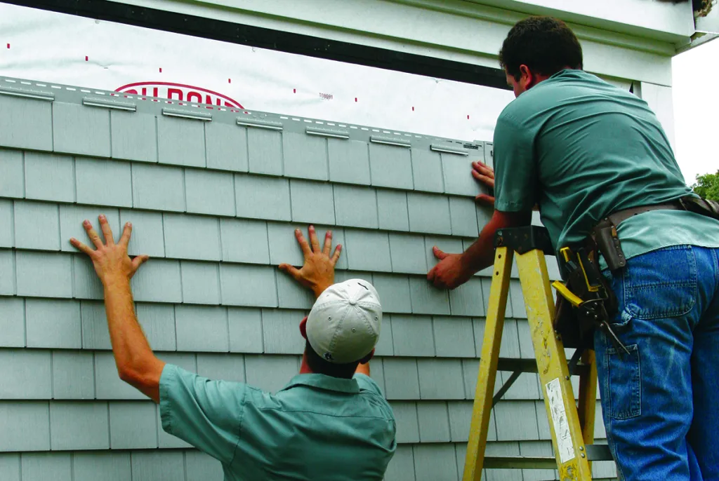

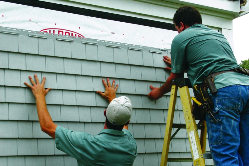

  • Lock panels along the bottom edge before nailing top edge. Do not force the panels up or down when fastening.
  • While the panel locks should be fully engaged, the panels should not be under vertical tension or compression when they are fastened. An exception can be made at the rim joist between first and second floors. When joists shrink, the panel may be forced down and may unlock, allowing the panel to flap in the wind. Keep some upward tension on the lock at this critical area to account for the shrinkage.
  • Start nailing in the center of the panel and work towards the ends.
  • Center fasteners in the slots to permit expansion and contraction of the siding. An exception to this rule can be made when fastening vertical siding and corner posts: In this case, start the top nail at the top of the uppermost slot to hold the piece at the proper elevation. All other nails should be centered in the slot.
  • Do not drive the head of the fastener tightly against the siding nail hem. Leave a minimum of 1/32 in. (the thickness of a dime) between the fastener head and the vinyl (Nailing Vinyl Siding, above).
