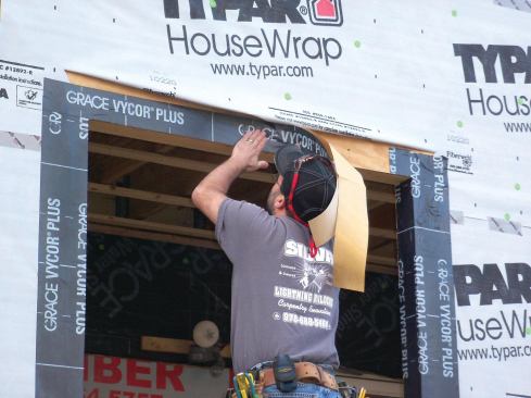

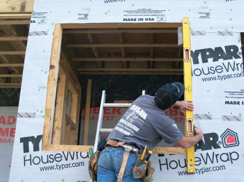

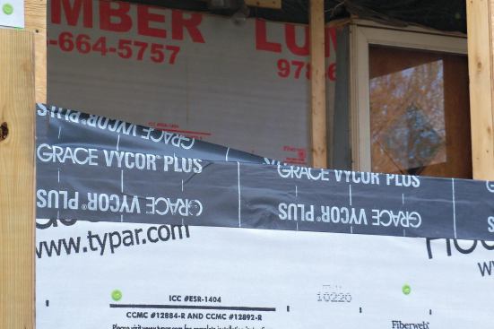

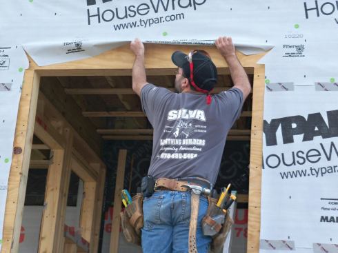

Assuming that the housewrap has been properly lapped and fastened to the sheathing, my first move is to cut it back from the sides and bottom of the opening by the width of my level, using the level itself as a straightedge. I leave it flush with the edge of the opening at the top. I then make a 6-inch cut at each of the top corners, angled back from the opening at 45 degrees, and temporarily tuck the resulting flap under itself to get it out of the way.

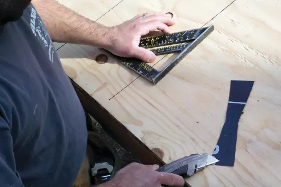

To make it easier to put the flashing on straight, I use my level again to draw plumb and level lines at the sides and bottom of the opening. The distance the lines are from the opening depends on the width of the trim, since the flashing needs to extend far enough to protect the joint between the casings and siding — but 6 inches is usually fine.

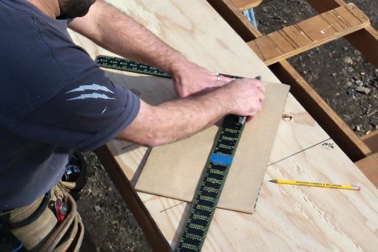

Cutting the flashing membrane. There are two separate sets of flashing pieces: the inner pieces that are applied to the sheathing and fold back over the framing, and the outer pieces that cover the window flanges. I cut both sets at the same time, determining their lengths by measuring directly from my markings on the housewrap. To calculate the width of the inner pieces, I add the distance the lines are set back from the opening to the depth of the framing, plus the thickness of the sheathing. For the 2×4 framing shown here, that came to 6 inches plus 3-1/2 inches plus 1/2 inch, or 10 inches even. The outer flashings are 3 inches or so wider than the window flanges themselves.

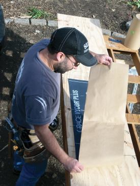

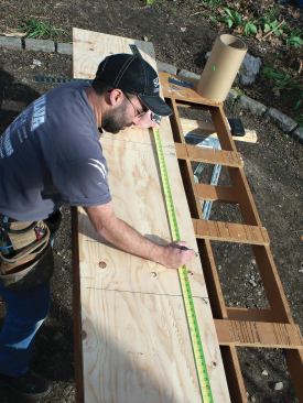

For accurate cutting, I transfer those measurements to a story board — fashioned from a piece of plywood about a foot and a half wide by 8 feet long — that I attach to my work table. I prefer Grace Vycor flashing because it’s premarked at 6- and 12-inch intervals, which simplifies measuring. I ordinarily buy it in the 12-inch width. Once I’ve cut the main flashing pieces to length and width, I cut a couple of “bow ties” to seal around the corners of the opening.
Flashing the sill and sides. The sill piece is applied first. If the rough openings have been sized to allow it, I’ll tack a full-length piece of clapboard to the rough sill before applying the membrane, creating an outward slope that will cause any water that somehow makes its way past the window to drain to the outside. In practice, though, this isn’t always possible — I had to omit the clapboard from the job photographed here because including it would have left insufficient clearance at the window head.

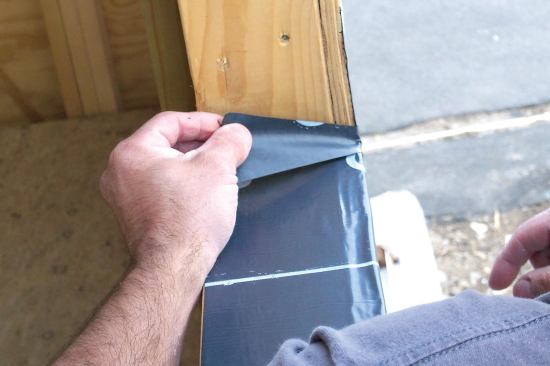

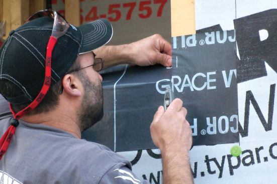

To apply the membrane, I first peel back enough of the backing to accurately position one end, then peel off the rest, keeping the bottom edge aligned with the pencil line on the housewrap. Next, I cut most of the way through one end of the flap that extends above the opening — starting from the corner but leaving a narrow connecting piece at the top — before completely cutting the other end free and folding it down against the sill. Once I’ve worked my way halfway down the sill, I cut through the last bit at the far corner with a quick jab of my utility knife and fold down the rest of the flap. This two-stage approach makes the material easier to control and helps prevent the formation of wrinkles and air bubbles.

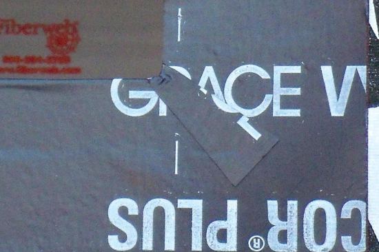

Finally, I apply a bow tie to each bottom corner, which serves to seal the small pinhole where the side flashing will later fold over the sill flashing. Although this area is often ignored, it’s a common source of leaks. When properly applied, the bow tie catches the end of the horizontal flap stuck to the sill, and turns the corner to extend a fraction of an inch up the trimmer stud.

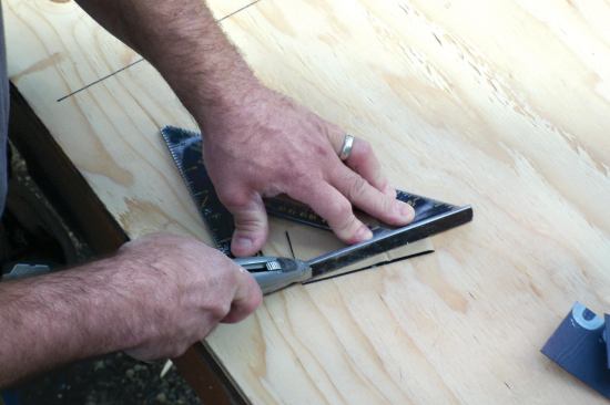

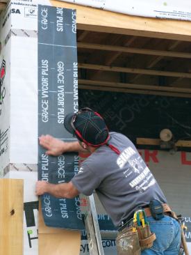

Side and head flashing. The side pieces are applied in much the same way as the sill piece, except that I start at the top and work down. But one important preliminary step comes first: When the side pieces are still on the story board, I cut a vertical slit through the bottom of each to create the flap that will be turned up and stuck to the horizontal sill flashing.

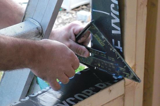

Once I’ve pressed the membrane against the sheathing and housewrap, I carefully fold the side flap into the opening and stick the slitted section flat against the sill, using a layout square as a guide to form a neat inside corner. I then work my way back upward, pressing the side flap against the trimmer and cutting it loose at the top when I’m partway along, similar to how I installed the sill flashing.

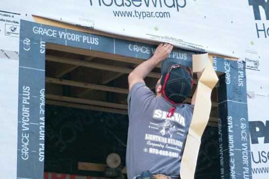

With both pieces of side flashing in place, I’m ready to install the head piece. This is easy, because there are no folds to make — the membrane is just stuck to the sheathing above the window, its lower edge flush with the opening and the ends lapped over the side flashing.

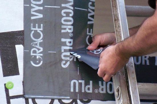

Once the window is secure in the opening and operating freely, I’m ready to apply the outer flashings. I install the side pieces first, working from the top edge of the inner head flashing to the sill, then I go back to the top and add the head flashing. Finally, I pull down the folded strip of housewrap at the top and seal the corner cuts with strips of housewrap tape. I don’t tape the bottom of the housewrap, so that any water that penetrates the housewrap can drain rather than soaking into the sheathing.
