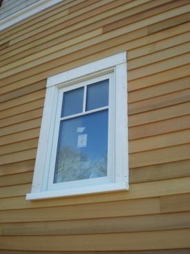

The aesthetics are determined in part by the size of the window, but the thickness of the wall can make the choice even more critical. Moving the window away from the outside of the wall requires exterior jamb extensions made from either the trim material or exterior siding. The farther inward the window moves, the more you accentuate the thickness of the wall.

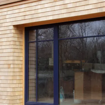

Performance. Next you need to consider comfort and the thermal performance of the window. From a thermal perspective, a window really should be placed in the center third of the opening to put it in the middle of the wall’s “R” value—not too cold, not too warm, but just right.
Placing the window in the outer third of the wall puts the window in the colder part of the opening, and you risk creating a microclimate in the window pocket, especially with smaller openings. This micro­climate carries the risk of getting cold enough for moisture to condense on the glass (a good reason for triple glazing). A colder glass surface also makes you feel colder when you’re standing next to it. As your body radiates heat toward the colder glass surface, you feel chilly.
From a durability standpoint, window placement is more complicated, because of the issues of water management. When exterior insulation is applied over the wall sheathing, I almost always align the window with the drainage plane/weather barrier to minimize the number of horizontal elements in the continuous weather-barrier system. Quick-draining, vertical scenarios make for a much more durable system. It’s not to say that an inward window, with an assumed weather barrier on the outer surface of the wall, can’t work, it’s just that you need to heighten your water-management awareness to account for the additional risk.
When I place a window in the center third of the wall, I need to create a system to drain water back out to the drainage plane on the exterior surface. I usually set the window on a piece of 5/4 or 1x3 to provide a “sill dam” that is my last defense for water intrusion. Then I install a tapered piece of wood such as cedar clapboard over the sill section of the opening and flash over the tapered board, running the sill flashing up and over the sill dam, and up the jambs at least 6 inches. As a result, I horizontally connect the window (part of my drainage plane) to the exterior sheathing (another part of my drainage plane), and the “innie” window is now integrated with the drainage system.
