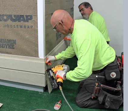

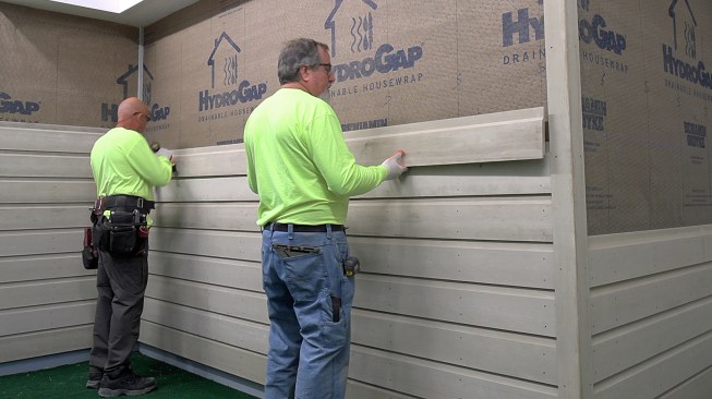

If you can install wood, you can install TruExterior. The process is almost the same. The big difference is that most of today’s exterior siding products have less tolerance for water and move more with seasonal changes, so you need to provide gaps at butt joints and intersections and fully prime and seal boards on all sides. Not having to do these last two steps at every intersection and every cut with TruEx saves an enormous amount of time.

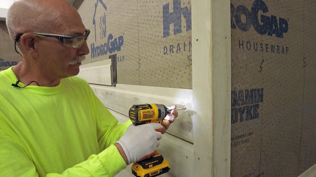

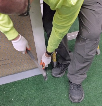

TruEx siding is typically face-nailed with 8d (2 1/2-inch-long) hot-dipped galvanized or stainless steel ring-shank nails, following the on-center spacing of studs so nails are driven into framing, not just through sheathing. Two nails in each stud works for siding exposures up to 8 inches; wider boards require three nails. We occasionally screw boards in place, particularly for homes along the coast where we want the greater withdrawal resistance to high winds. When we do, we follow the same schedule the manufacturer requires for nails.

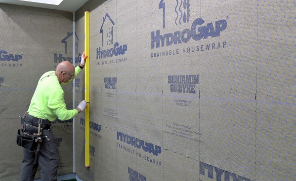

Though TruExterior is hydrophobic (naturally water repellent), water will still leak behind it or be drawn through gaps by capillary action, as with any siding. Therefore, it is important to establish a drainage plane behind the siding before installing it. I don’t think flat housewrap or black paper cuts it as a water-resistive barrier (WRB), as water tends to get held by surface tension between the back of the siding and the WRB and is slow to dry. The water can’t hurt the siding, but there has long been evidence that with a pressure differential, water can seep through most housewraps into a framed wall, mostly through nail holes (see “Water-Managed Wall Systems” by Joe Lstiburek, Mar/03). I recommend a drainable housewrap or a rainscreen. I typically use Benjamin Obdyke’s Hydrogap housewrap, which leaves a 1mm (about 1/16 inch) drainage space behind the siding to allow water to drain down the wall. Remember to look for where the water will escape at the bottom and plan for drainage with drip caps and flashing at head trim, transition boards, and skirt boards. Drainage gaps should not be caulked; the water must be able to drain freely away.
Field joints on siding runs can be butted; no gap is required. I like to install flashing strips behind field joints to minimize water intrusion, but it’s not required by the manufacturer. (Bearskin makes 6-by-12-inch joint flashing strips; I cut my own from a roll of Benjamin Obdyke InvisiWrap housewrap, which is UV stable, using a saw.)

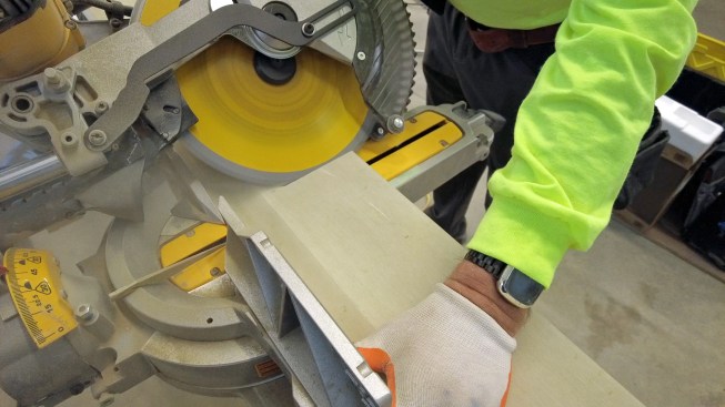

Where siding butts corner boards and door and window casings, a tight fit is also acceptable. A good miter saw will give a perfect “factory-look” finish to cuts. (I use the stock 32-tooth blade that came with my saw.)
At roof-wall intersections and above door and window heads, the only requirement is to leave a small drainage gap. Generally, 1/4 inch is sufficient, but at roof intersections and above exterior decks, the manufacturer calls for 1/2 inch to limit fine debris collecting. This gap is still much smaller than the 1 inch or more needed for wood and fiber cement. It’s also important to install kickout flashings at the end of roof-wall intersections (see “Kickout Flashing: Required by Code, Yet Often Overlooked” by Mike Guertin, Oct/19). This is not for the siding’s sake; it’s needed for keeping the volume of water that gathers here from leaking into the structure.

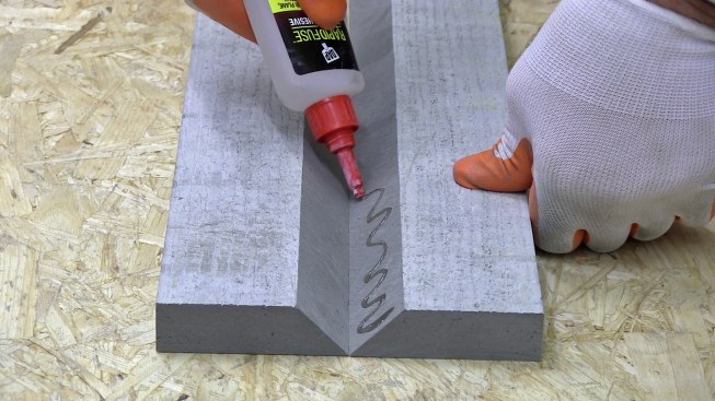

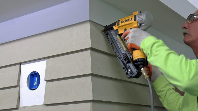

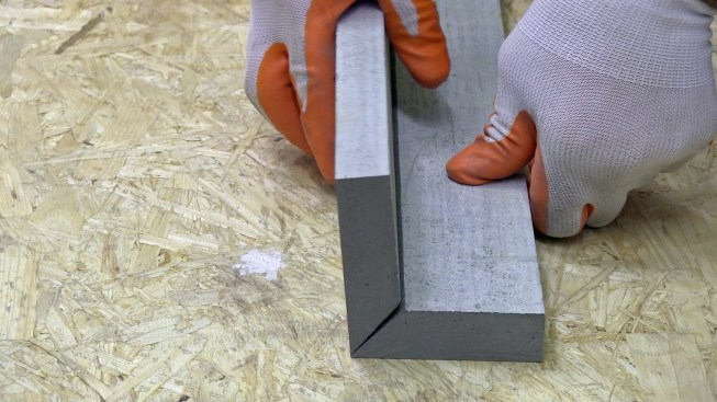

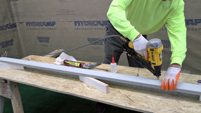

Corners. TruExterior currently does not make corner boards. We rarely use them; instead, we miter the siding boards, gluing and clamping the miter before nailing it off. (We have used a polyurethane glue, such as Gorilla Glue, and recently have been using Dap RapidFuse Wood Adhesive—a hybrid glue that creates a strong bond on poly-ash and sets up fast.)

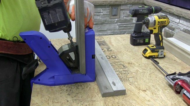

When we do use corner boards, we preassemble them using a miter at the outside edge. I have also joined corner boards with lock miters, cut with carbide bits on a 2-hp router on a table, as shown above. But to be honest, a lock miter is overkill; a mitered corner looks just as good, and because the material doesn’t move around, it works as well too. You could also use a lap joint, as you would with a wood corner; it works well to apply a bead of compatible glue and nail the corner off with hot-dipped galvanized or stainless steel nails. However, I prefer the clean look of the mitered edge, and miters have never opened on us.

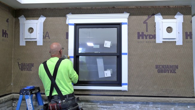

Mounting blocks. For outlets and fixtures, you can go one of two ways: Using 5/4 TruEx stock, you can make your own mounting blocks, or you can purchase premade poly-ash blocks from SturdiMount. These are easy to flash using peel-and-stick flashing tape.

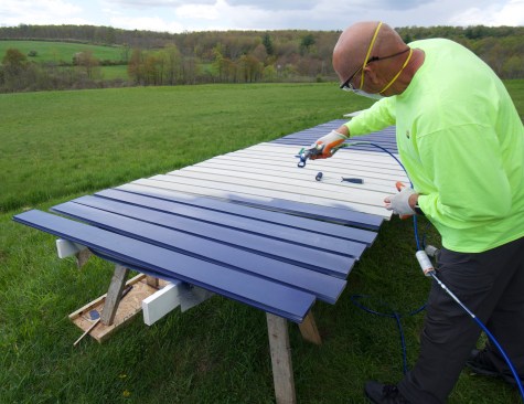

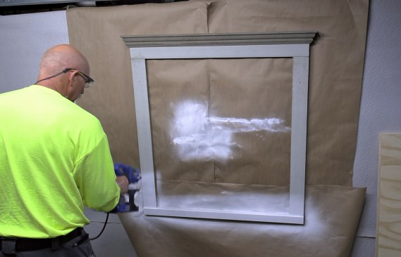

Finish. Before installing material, I typically apply a coat of finish paint (I use Sherwin-Williams Emerald Rain Refresh). This is especially important with a nickel-gap profile—you do not want to paint those nickel-size gaps later. Remember, though, that with TruEx, there is no need to paint anything that is not exposed, and paint will last a lot longer on TruEx than on wood since there is no water cycling.
The author prefers to prefinish both siding and trim before installation. Here he uses a Graco 390PC airless sprayer.
One piece of advice: If you spray finish the siding, finish it off with a roller as per the manufacturer’s recommendations. The spray finish develops air bubbles that need to be knocked down with the roller for a smoother finish.
