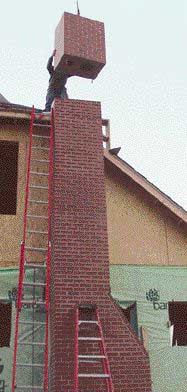

Delivery and Installation
It ordinarily takes about six hours to complete an installation, and we can show up on the site any time after the foundation has been poured. When possible, though, we prefer to wait until the house is framed and sheathed, because this lets us install the attic tie without making an extra trip.
Site access. For best results, we need to be able to pull our boom truck to within 30 feet of the chimney footprint. Our truck has the reach and capacity to boom over the roof, but the lack of visibility makes that pretty nerve-racking. It’s a complication we try to avoid whenever possible and one reason we’ll consider setting the fireplace before the house is framed.
The modular chimney sections arrive on the site in a ten-wheel truck. It’s up to the builder to provide unrestricted access to within 30 feet of the chimney footing so the modules can be boomed into position.
Stack ’em and grout ’em. When we get to the site, we check the chimney bumpout for size and level before lowering the first section into place. That’s followed by the firebox section, which is joined to the first with grouted dowels and refractory sealant. The joint between sections is tuck-pointed with mortar, leaving it indistinguishable from those above and below.
The chimney bumpout is poured with the foundation but generally needs to be about 4 inches higher (depending on the floor system) than the foundation walls. The first section is lowered and protruding dowels are grouted into it, making the final assembly strong enough to be completely free standing.
The aluminum flashing piece fits into the joint that falls at the roofline. Although the chimney is designed to be completely free standing, we also install an attic tie to appease nervous builders and inspectors. Once the final section is lowered and the cap installed, it’s tough to tell our chimney and fireplace from site-built.
Section lengths can be adjusted in 6-inch increments so a joint occurs at the roofline, where a one-piece aluminum flashing will be inserted. Although tests have shown that the free-standing chimney has the strength to withstand 120-mph winds, an attic tie is also installed at this point.
The completed chimney is difficult to distinguish from site-built masonry because stencils prevent the red stain used on the “brick” from discoloring the naturally gray “mortar joints”; realistic “corbelling” below the cap enhances the brick effect. A rain cap­spark arrestor completes the installation.
We’re often asked what happens if the chimney is damaged after installation. One builder wanted to know what would happen to the chimney if he ran into it with his backhoe. The answer is that while we don’t recommend bashing it with heavy equipment, a cast chimney is much tougher than one made from bricks and mortar. Minor damage can be easily field repaired with mortar and touched up with stain.
