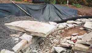

Because a retaining wall has to withstand the pressures of the slope it is retaining, we typically dig the area behind the wall back to its angle of repose — the angle at which a slope is self-sustaining for a given type of soil. This angle is heavily dependent on the soil type but, as a very loose rule, it averages about 45 degrees.
With the final height of this poolside wall as our guide, we dug into the slope so that the bottom of the cut was 2 feet back from the back surface of the wall (to allow for crushed stone at the base of the wall). The distance from the top of the wall to the cut line was 2 feet plus the height of the finished wall.
After the excavated slope was covered with landscape fabric, all of this excavated area was filled with #2 crushed stone (a large crushed stone of up to 2 inches in size) to allow for drainage.
To reduce soil pressure, the ground has been excavated behind the retaining wall at an angle of about 45 degrees, then backfilled with #2 crushed stone to enhance drainage. Lining the excavation with landscape fabric helps keep soil from washing into the crushed stone, which would diminish its ability to drain properly.
In cases where plantings will be used, we usually backfill to within about 12 or 18 inches of the top, lay down another layer of landscape fabric to keep the soil from filtering down into the crushed stone, and then fill in with topsoil.

1 over 2, 2 over 1. Dry-stacked walls rely on two forces of nature: gravity (or mass), and friction. To maximize both forces, we always use as large a stone as we can. To increase friction, it's important to overlap joints as much as possible (Figure 6). One stone sitting on top of two will apply gravity and friction to both, creating a much stronger wall. By avoiding long, vertical seams, which act like fault lines and become points of failure, we essentially tie the whole wall into itself.
When placing the stones, it's best to avoid vertical joints and try to overlap each stone over two others. Here, the worker had to align two joints to make room for electrical conduit that will eventually supply built-in lighting fixtures.
As the wall goes up, we're careful to lay up stones so that their longest edges project into the wall — rather than orienting them parallel to the wall's face — even when the stones have especially clean and beautiful faces. This technique results in a stronger wall.
When we build our walls, there is always rubble left over from cutting or breaking rock. We use this "waste" as infill, tightly packing the rubble behind the face of the retaining wall. And we place the infill carefully — rather than just tossing it in — so that it doesn't settle over time. We also use pieces of rubble to shim the face stones into position, leveling them and locking them in place.
Resembling a triangle in cross section, the retaining wall is carefully backfilled with unusable stone, rubble from cuts, and crushed stone. Members of the author's crew rely on spirit levels and a trained eye to ensure that the curved wall remains both level and consistently battered back about 10 degrees from the vertical while they lay up stone.
