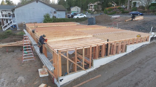

While the design featured 10-foot-tall basement walls, the top of the floor system needed to be flush with the top of the mudsill. This means that there is no rim joist along the front of the house; instead, to minimize the height coming into the house, there is only the top of the foundation wall. To execute this design, we had to frame bearing walls along the inside of the house’s foundation walls to support the floor system.

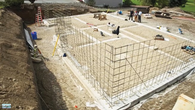

Shown here are the expanded footings for the columns and bearing walls that will support the framing underneath the garage slab, and the steel reinforcement for the 10-foot-high foundation wall.

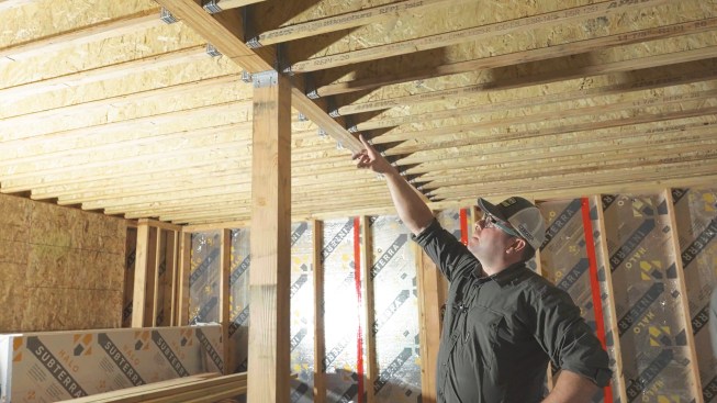

A 5 1/4-inch-by-11 7/8-inch flush beam that bears on midspan and end-span columns was installed to support loads from the slab and two cars.
Note that the entire subslab floor system is dropped below the main-level floor system to accommodate the thickness of the garage slab.
The exterior walls above are bearing on the stem walls. This affected the footing design. The footings are 2 feet wide by 1 foot deep with three #4 rebar running the length of the footing. The footing is slightly biased toward the inside of the house to support the basement slab and framed walls. On the north/south walls, running parallel to the joists, the footings are 2 feet 6 inches by 12 inches deep with four #4 rebar, again biased toward the interior 1 foot 3 inches. That had mostly to do with the joists running parallel to the foundation wall.
The center column was needed to allow the rest of the ceiling below the slab to be flush-framed.

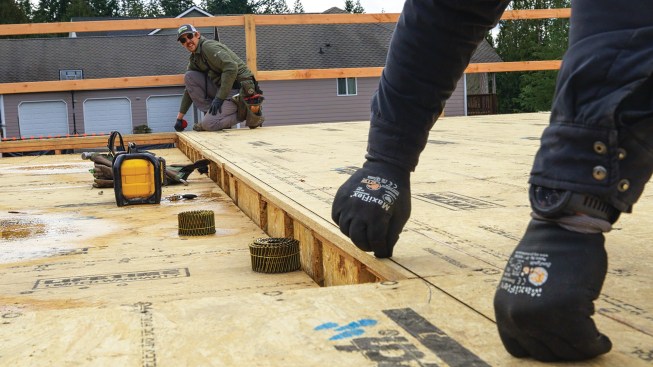

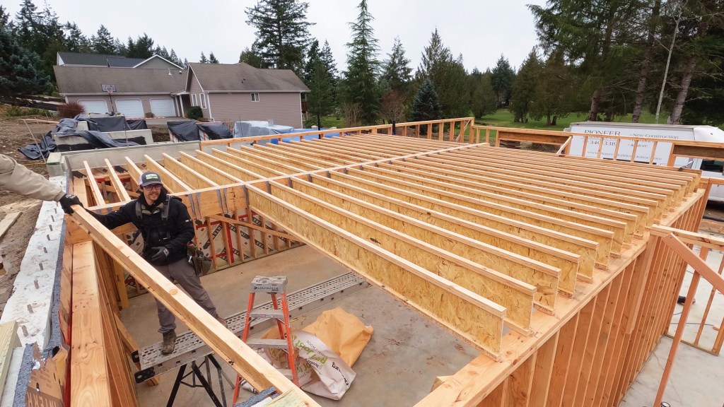

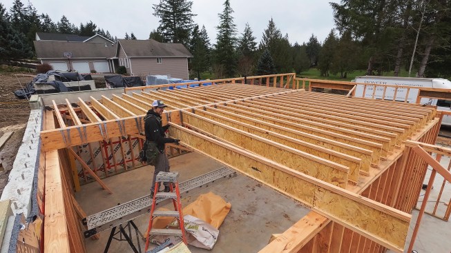

Here, a worker is installing one of the main-level I-joists above the walk-out portion of the basement at the back of the house.

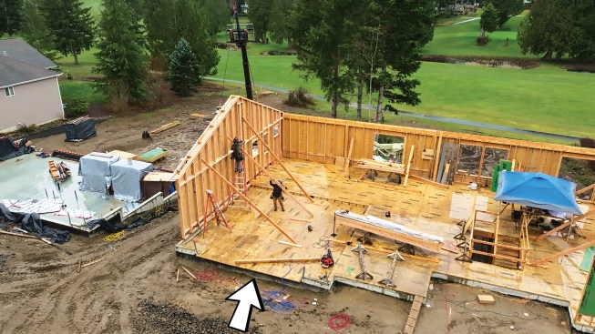

The subfloor sheathing at the garage entry (see white arrow) will need to be cut back to allow the slab to be pinned to the foundation wall.
The shear walls on the main level were framed so that they are aligned with the shear walls underneath the garage slab.

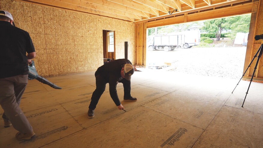

Slab prep. This isn’t the first time we’ve installed a garage slab over wood framing. I remember a few projects that we completed in the early 1990s with a similar detail, mainly because I had to tediously hand-nail joist hangers for tightly spaced 2x12 joists. On this job, we spent considerable effort raking debris out of the joints in the subfloor sheathing and then cleaning off the dust with a leaf blower.
Before rolling out the subslab membrane, the author raked out the sheathing joints and blew the dust off the subfloor.

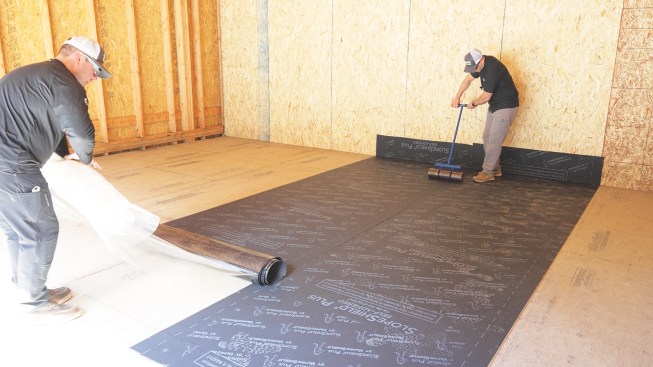

To protect the AdvanTech subfloor from the concrete slab on top of it, we used a highly vapor-permeable roofing underlayment called SlopeShield Plus SA (vaproshield.com), designed for mass-timber floor and roof decks. Similar to an ice-and-water-barrier product but vapor open (30 perms), SlopeShield is designed to block bulk-water intrusion but allow long-term drying of a roof or subfloor assembly through vapor diffusion.
SlopeShield measures 20 mils thick and comes in 59-inch-wide-by-102-foot-long rolls. It has a release film backing, and my brother and I were able to install it quickly. There is no need for a primer, and the pressure-sensitive adhesive allowed us to reposition the membrane as needed as we rolled it out and pulled off the release film. As recommended, we used a 100-pound vinyl-flooring roller (that our flooring contractor let us borrow) to roll out the product; once we did, the membrane was permanently stuck to the subfloor. The roller is definitely a “must use” with this product.
A heavy flooring roller was used to help adhere the SlopeShield Plus SA underlayment to the subfloor.

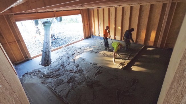

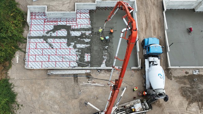

Concrete. No special prep was required for placing the concrete because the floor is flat and designed for the load. We use a 4,000-psi concrete mix, which we’ve confirmed with third-party testing at least twice over the years.
The 4,000-psi concrete for the slab was placed without rebar.
We elected to go without rebar because it doesn’t prevent cracking, and the underlying structure isn’t going to be moving. Since all concrete eventually cracks, we discussed the locations of the contraction joints with our flatwork subcontractor to make sure any cracking that does occur looks intentional. It’s important to break up the area with enough joints to prevent unintentional cracking elsewhere. He does an outstanding job tooling in the joints.

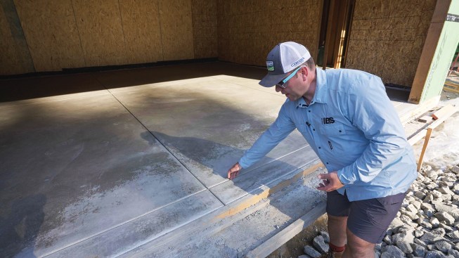

Contraction joints were strategically located, including over the joint where the slab thickness transitions from 10 inches over the concrete stem wall to 4 inches where the rest of the slab is supported by the wood subfloor.

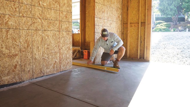

The slab was given a steel trowel finish and tapers away from the entry into the house for a smooth transition.
The slab tapers from 6 inches thick at the back wall to 4 inches thick at the garage door opening for drainage (there is no center drain). For a flush, wheelchair-accessible transition, we created a slight taper in the slab between the garage slab and the entry from the garage into the house.
