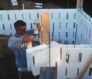

Polysteel forms are 4 feet long, and they come in 1-foot, 2-foot, and 16-inch heights. The top, bottom, and ends have a tongue-and-groove profile, so they stack precisely and the forms lock together to a certain extent. Setting up the forms is simple. You pour your footing using conventional methods, and snap lines for your foundation footprint the same way you would for conventional forms. The first course of forms is adhered to the footing with a thin, continuous bead of polyurethane foam. From there on up, setting the forms is something like building with toy Lego blocks: You just stack them up, using a little dab of foam at all abutting edges to “tack” things together. (We cemented all the blocks together with a continuous bead of foam because we had plenty on hand, and that worked fine — just don’t use so much foam that it pushes things out of alignment as it expands.) When you come to a corner, you use a right-hand or left-hand corner form.

Placing forms. You stack the blocks up one course at a time, always beginning in a corner (Figure 2). If your foundation is the right size, you can go all the way around the footprint without cutting any forms until you get back to where you started. But you’ll usually have to cut at least one form at the end of the circuit, and you may need to cut one in every length of wall as you approach the corner. In any case, you alternate left and right corner forms as you go up the wall, and stagger the end joints of the form blocks so they don’t fall out above one another.
Figure 2.Walls are stacked one course at a time; corners are laid up using alternating left-hand and right-hand corner blocks. Polyurethane foam is used as “glue” between trimmed forms that lack the usual tongue-and-groove connection, but added exterior reinforcement is also needed in those areas.

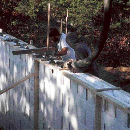

Cutting and splicing. Whenever you cut a form, you’re trimming off the tongue-and-groove connection, and you need to replace it with a strong splice. Running a bead of polyurethane foam between the cut forms helps keep them in alignment, but the easiest way to provide the needed structural strength is to place a small piece of plywood to span over the joint and screw it to the nearest steel furring strips on the forms. In our experience, it’s worth taking time with splices, and even providing each splice with its own brace back against the soil. The only time we had trouble during our pour was when a splice started to give way.
