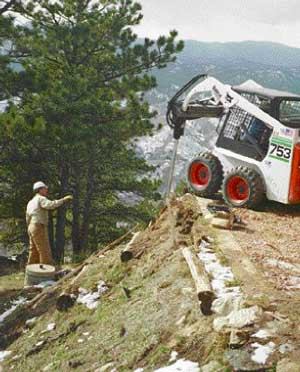

Helical piers don’t require huge spaces for site access because they can usually be installed with a mini excavator or skid-steer loader. We can often drive around a fence or through a gate to get to a backyard. We can also work on steep sites and ledges that would be nearly impossible otherwise. Compared to a concrete foundation, installation is extremely fast; we can usually shave a week or two off a project schedule. In addition, we don’t have to be concerned with weather delays — while inconvenient, freezing temperatures and rain won’t stop a job. Minimal excavation is required, and you don’t have to store the excavated soil while you wait to backfill. That means that the existing landscaping is typically left undamaged.
Piers also solve problems like digging next to an old stone foundation that would likely collapse if disturbed. They’re great for areas with shallow water tables and caving soils.

We install the piers with a mini excavator or skid-steer loader and a hydraulic auger attachment. This equipment is small and very maneuverable and works well for most locations. The process starts with the installation of a 6-foot lead (the part with blades). It’s driven down to grade, then 6-foot extensions are bolted on as needed. The leads and extensions attach to the auger powerhead with a grade-8 bolt. Installing one pier usually takes about 30 minutes to an hour.
In our area, the soils are usually soft enough to accept the piers, but bedrock and localized sections of hard rock called “rock lenses” can be a problem for helical piers. If a pier won’t advance, it’s easiest to back it out and try one with a smaller diameter that (hopefully) won’t encounter as much resistance. If that doesn’t work, you can move the pier location to the left or right. The amount you can move a pier depends on the structure, and you’ll want to consult your engineer, but in most cases you can move to the left or right about a foot without a problem. If that doesn’t work, you may have to take more drastic measures, like bringing in a drilling rig to make a “pilot hole” or pinning a concrete caisson to the offending rock. Thankfully, we’ve never had it happen, but piers sometimes get stuck and won’t advance or back out. In that case, the only solution is to either cut it off or work it back and forth until it’s free. Another good reason to get a soils report is to avoid these kinds of frustrations.
