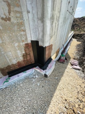

After the walls were poured and the forms stripped, the crew prepped the wall-to-footing joints with more primer, then applied 9-inch-wide Mel-Rol detail tape to seal these tricky intersections.
The crew also sealed both the inside and outside corners of the foundation with Mel-Rol detail tape, overlapping the taped wall-to-footing joints.

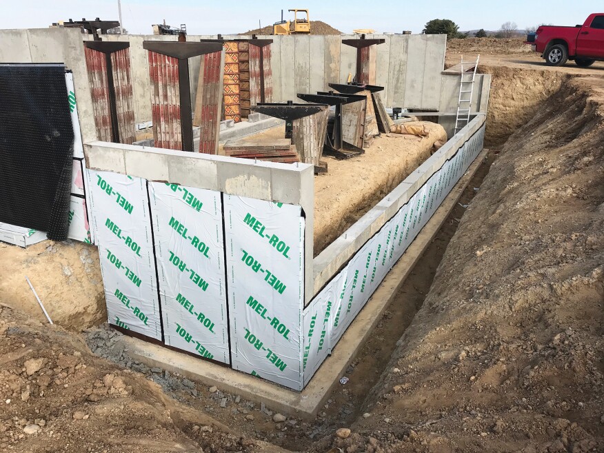

Then the crew began applying sections of membrane vertically to the primed foundation walls.
The waterproofing membrane terminates 12 inches below finish grade.
We then rolled the membrane using Zip System rollers, as they were the tools at hand. The Mel-Rol did have some air bubbles that became stuck but, with the thickness of the membrane and the subsequent Mel-Drain creating a belt-and-suspenders system, we felt comfortable not over-focusing time and effort into pushing all the bubbles out.
