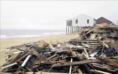

Along the eastern seaboard and Gulf Coast, most building codes require beachfront homes to be elevated on piling with little or no obstruction between vertical supports. In a severe storm, an elevated, "open" foundation will allow floodwaters to wash underneath the first floor without putting an excessive load on the structure and bringing down the house. Under current National Flood Insurance Program (NFIP) standards, which largely dictate local building codes in coastal communities, open foundations are required for homes in coastal flood zones that are rated for "velocity wave action" (V zones). This typically includes only the first row of homes on the beach. For homes in less exposed zones, piling foundations are widely recommended but rarely required, despite an overwhelming body of evidence that broader application of V-zone standards would mitigate much of the damage from storm surge.
SOURCE OF MAXIMUM DESTRUCTION
Storm surge is a swelling of ocean levels preceding a severe storm. The swirling winds created by hurricanes and other cyclones can push up a dome of water as large as 50 to 100 miles wide in front of the storm, leading to an increase in water levels ranging from 4 to 6 feet in a minor hurricane, to greater than 20 feet in big storms (when it combines with high tide). The level of the surge depends, in part, on the slope of the continental shelf along the coast. The shallower the coastal waters, the more floodwaters surge ashore. In most places, the shelf surrounding the Atlantic and Gulf shores is relatively wide and shallow, and most of this densely populated coastline lies less than 10 feet above mean sea level. Consequently, the danger from storm surge is tremendous. According to the Federal Emergency Management Agency (FEMA), in nearly every hurricane on record, storm surge is responsible for more deaths and more property damage than any other effect of the storm, even high winds.
In North Carolina, a 15-foot surge in front of Hurricane Floyd flattened Oak Island's frontal sand dune, then took down homes like the one shown on the left, which once stood on a ground-level block foundation. Damage inspectors reported that the home likely would have been saved if it had been elevated on piling like that shown on the right. (Photo courtesy Dave Gatley/FEMA)
Waves can exert enormous pressures on buildings. While winds wield pressures in the tens of pounds per square foot, a 2- to 3-foot wave can exert pressures in the hundreds or even thousands of pounds per square foot, says Christopher Jones, an engineer from Durham, N.C., who wrote the current edition of FEMA's Coastal Construction Manual-FEMA 55 (available free from FEMA; 800/480-2520). These are forces that ordinary solid walls can't easily resist.
Despite the magnitude of the force, protection proves relatively straightforward: Simply elevate the house above the surge. In storm after storm, inspectors assessing damages report that homes elevated on piling survive relatively unscathed compared to older homes supported by solid foundations (see "Lessons Learned After the Storm," below). Homes that are not elevated are frequently inundated with floodwater or swept off their foundations entirely.
