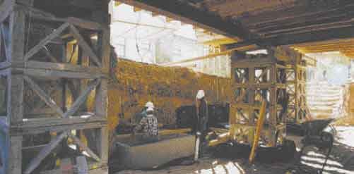

Crib shoring. When the layout of the site doesn't permit us to bring in beams long enough to use free-span shoring, we sometimes have to resort to crib shoring instead. A typical crib is a square wood frame about 2 feet high, with internal diagonal braces. Such frames are stacked below wood or steel beams to provide support where needed (Figure 5).
Figure 5. Where full-length shoring beams are impractical, shorter beams are supported by cribwork as needed. No stitch piers were required to support the solid soil forming the face of the excavation shown here. The concrete vault will eventually house a sump pump.
When we're using cribs, the excavation becomes a real chore. At the start of a project, the soil level is typically 18 inches to 2 feet under the bottom of the joists. When the shoring beams are installed, they're supported on stacked timber and jacks in the crawlspace. The beams are initially very close to the ground, so digging must begin in an area where there are no cribs or jacks. Once we've created a slot between the cribs or jacks to a safe working depth, we have to take time to "jump the crib" -- placing a new intermediate support before removing the crib in the previously unexcavated area. Digging out a large foundation in this way can take weeks, compared to just a few days if clear-span shoring is used.

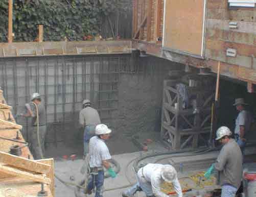

On many tight lots, though, there simply isn't enough room to form and pour foundation walls. In those cases, we use shotcrete -- a high-quality sprayed concrete that minimizes form work and can be applied even in tight quarters.
Single-sided forms. One approach to placing shotcrete involves forming the outside surface of the wall with single-sided snap-tie forms, placing the rebar grid on the inside, and applying the necessary thickness of shotcrete (Figure 9). The amount of steel specified will vary with the preference of the engineer, the height of the wall, and the local soil conditions. A single grid of #5 steel at 12 inches on-center is fairly typical, but some walls call for two or even three times that much steel. Unless it is very high, a shotcrete wall is usually 8 to 12 inches thick.
Figure 9. Gunning shotcrete against a single-sided form, rather than directly against the excavation, provides space for stone backfill and affords more control over the waterproofing on difficult sites.
