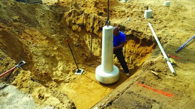

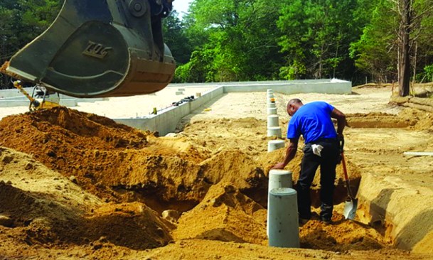

The site crew dug the hole for each precast footing individually, compacting the base of the hole and using a laser level to set the elevation.

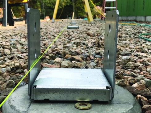

Each footing has an integral fitting for an eyebolt that was used to lift and place the footing. After the footings were placed, the crew used the fittings to attach the post connectors.

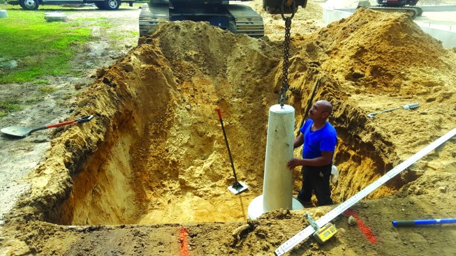

To set the footings, we had to maintain two critical parameters: The 11 footings all had to be set at exactly the same elevation, and they all had to be in a perfectly straight line. With the extremely sandy Cape Cod soil, it made sense to excavate each footing separately. The frost depth for this location was 4 feet, so we excavated to exactly that depth below rough grade. Because the precast footings are 5 feet tall, that left 12 inches of vertical play for the drainage layer under the porch that we would install later.
Botelho’s crew compacted the base soil in each excavation by hand, setting the depth of each hole with a laser and a measuring stick, which gave the holes the vertical accuracy that we needed. The crew used an excavator equipped with a chain for the actual placement of the footings. A hook on the end of the chain grabbed an eyebolt threaded into the fitting on the top of the footing. The excavator easily lifted the footings into place, setting each one on the compacted, undisturbed soil of the hole excavation.

As the crew placed each footing, they measured off the foundation as well as off the center point of the previous footing. The footings were 8 feet on-center. The crew set up a 100-foot string parallel to the foundation and a second laser as a secondary check of the footing alignment. The string provided a true sight line to work from and the laser provided a continuous line along the tops of the footings.

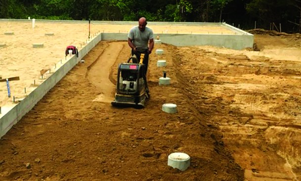

After setting each footing, the site crew backfilled about 2 feet and compacted the fill, which helped to lock the footings in place. After the initial compaction, they quickly checked that the footings were still in perfect alignment. The crew completed the backfilling in two more lifts, compacting each layer and checking after each compaction to make sure the footings stayed in perfect position.
Backfilling in lifts and compacting between each layer locks the footings in place.

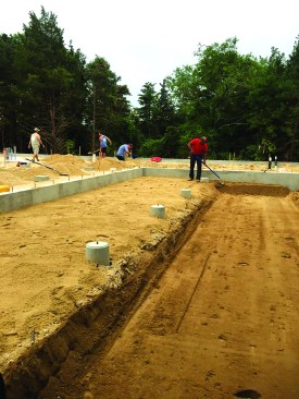

Because this home has no roof gutters, it would rely on a perimeter ground-gutter system (see “A Primer on Water Management,” Jun/17). The ground gutter is designed to carry groundwater and roof runoff to an area of reclamation on the other side of the site. The porch was to be open to the weather, so we had to tie the area below the porch into the ground-gutter system. After the site crew finished backfilling around the footings, they compacted the top layer of soil, sloping the grade away from the foundation slightly toward the outer edge of the porch.
The grade drops just beyond the footings, for the ground gutter.

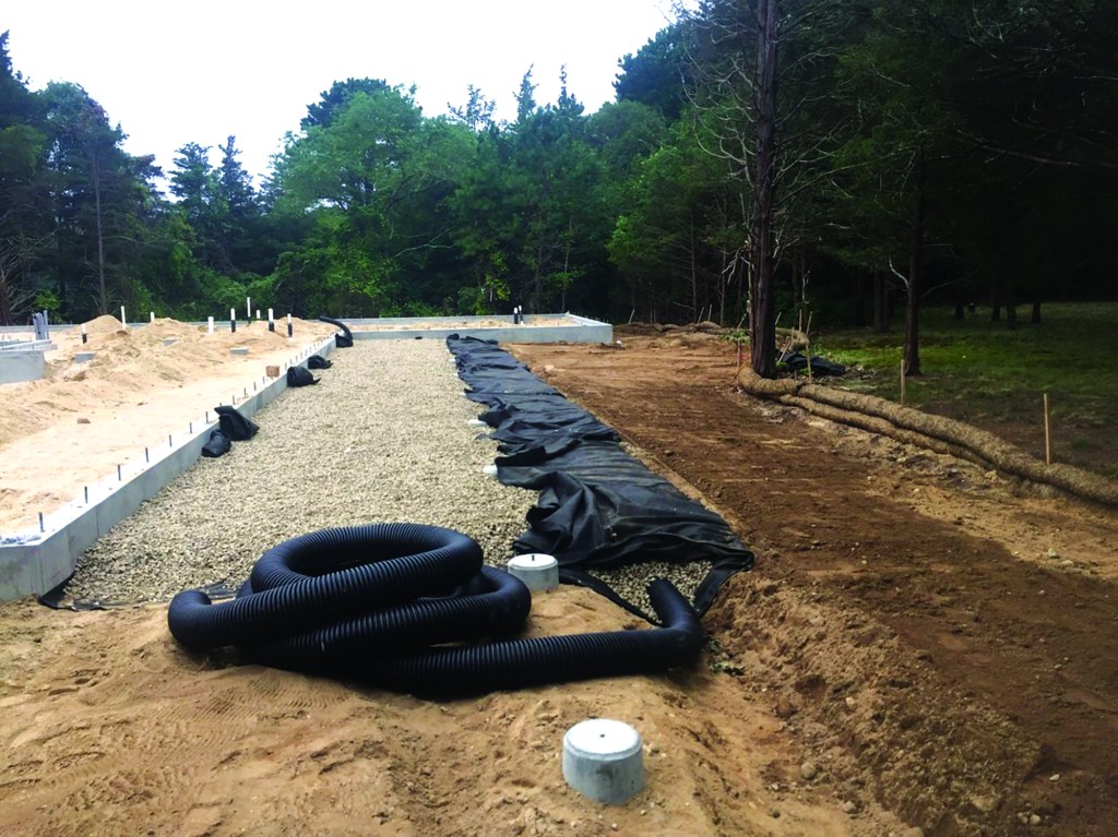

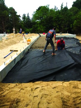

Just beyond the line of the footings, the grade dropped sharply about 18 inches to form one side of the ground gutter. The crew covered the sloped ground with heavy-duty filter fabric and then added an 8- to 10-inch layer of crushed stone on top of the fabric. The crushed stone would drain any water that filtered through the porch floor above. The filter fabric continued beyond the footings to line the ground gutter, and it was intentionally left long so that it could roll back over the stone to fully encapsulate the drain pipe and the stone around it. We centered the drain pipe side-to-side in the ground gutter so that it sat directly below the “drip line” of the porch roof above.
Then it wraps back over the crushed stone and drainage pipe.

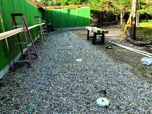

Before the porch framing could begin, we quickly checked the footings again to make sure that they were all still perfectly in line. When all was said and done, Botelho and his site crew had placed all of the footings within 1/8 inch on-center of each other, a level of accuracy and consistency that would have been difficult or nearly impossible to duplicate with poured-in-place footings.
Crushed stone filled the area under the porch up to the tops of the footings.

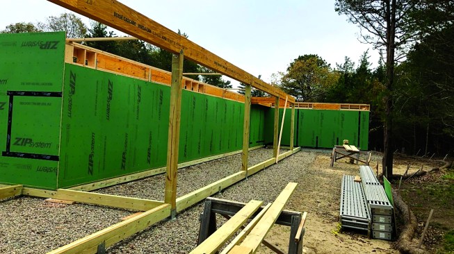

The crew checked the alignment of  the footings at every step, and a taut  string confirmed that both the height  and the placement of all 11 footings along the 78-foot length of the porch  were within 1/8 inch.

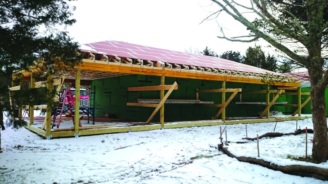

The high degree of accuracy meant that the  treated beams supporting the porch  were installed without a hitch.
The precision was critical for engineering the roof frame to withstand severe uplift in this high-wind area.
When the framers arrived, they were pleasantly surprised to find such an accurate layout. The precision of the footing placement allowed them to quickly install the treated frame, columns, and beams for the porch. And this precision continued throughout the frame; from the straight and level lines of the footings, the crew efficiently placed the grade beams, posts, roof beams, and roof trusses in perfect alignment.
