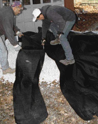

Figure 2.Geotextiles have become a commodity product, with many companies competing to provide choices across the whole range of strength, porosity, and other properties. Silt fences (left) and filter wraps for trench drains (right) are familiar uses to most builders.
