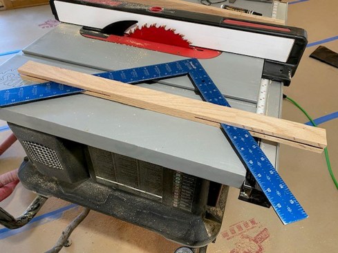

To avoid these problems, I stopped using stair gauges and made a sliding jig that I use with the framing square instead (see slideshow, above). It’s simple to make on a table saw. The square slides in a kerf cut on each end of a 1×2, and I clamp the sides together with small C-clamps when stepping off a stringer. (Eventually, I’d like to add threaded inserts and small knobs.)

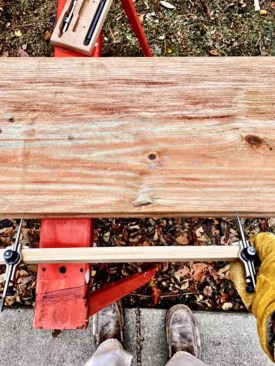

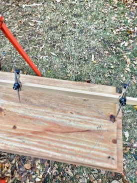

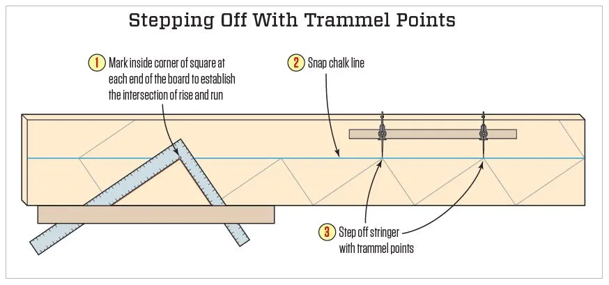

To improve accuracy, I moved to stepping off the stringer with trammel points. I set up my trammel points on a board the length of the hypotenuse of the stair’s rise and run, and at first used this trammel set to step off the distance along the edge of the board.
I eventually evolved this process further by avoiding the edge of the board entirely. Instead, I work along a chalk line I snap down the length of the stringer. This line passes through the inside corner of each stair step. The step distance is exactly the same as the step distance at the edge, but using a straight line down the middle of the stringer helps to keep things more consistent.

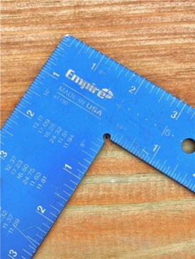

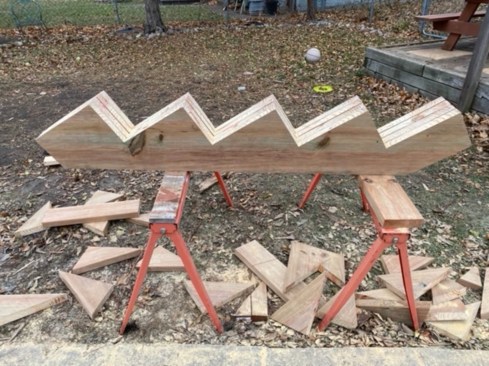

Empire’s framing square has a cut-out milled at the inside corner that makes it easy to line up a trammel point at the exact inside corner of the square. I use this point to define where to snap my line, and after stepping off the inside corners of the stair with the trammel set, I line the square up on the points I have inscribed with the trammel points to draw cut lines for each step. This method adds a few movements, but it eliminates minor errors, allowing for a perfect set of stringers, even when the lumber is a little rough.
