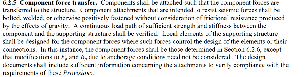

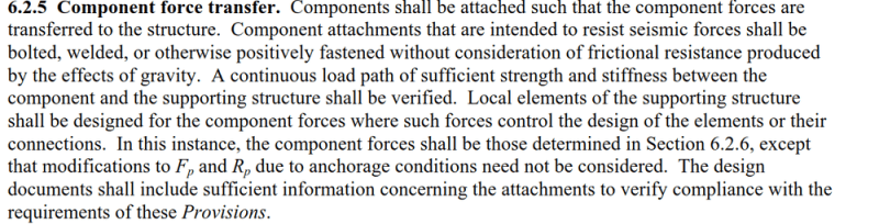

What does a “positive connection mean”? FEMA defines it this way:
That statement “otherwise positively fastened without consideration of frictional resistance produced by the effect of gravity” makes this clearer for me. I often thought “well, the weight of the building is holding that beam in place plus the joists themselves.” Below are a few examples of “positive connections.”

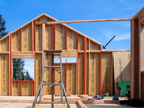

This balloon-framed rake wall needs to be strapped horizontally at the 4x6 “fire blocking” (which is also the panel edge blocking for the sheathing) to the double top plates.

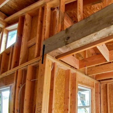

Walls are strapped together under the beam, but the beam needs to be strapped to triple 2x6.
The same wall as in the previous photo. The upper row of blocking needs to be strapped to the double top plates of the level portion of the wall.
