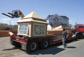

The company I work for, Baud Builders, builds custom homes in the coastal areas of Rhode Island. The homes are architect-designed and typically have plenty of interior and exterior millwork. I spend most of my time in the shop, prefabricating many of these components, to make time on site as efficient as possible. One recent project featured a glazed cupola, which lent itself to a unique approach: Rather than messing around on the rooftop, we decided it would be much easier to build the cupola in the shop, then truck it to the site and crane-lift it into place. The plans specified the general look of the cupola and the window units to be used (Eagle awning windows), but provided little else in the way of guidance or design. Our strategy was to have the framers create a square opening through the roof and build a mounting hub — like a stubby, wood-framed chimney through the ridge — based on rough dimensions provided by the building plans. The hub, framed with 2x4s and sheathed with 3/4-inch AdvanTech, measured 541/2 inches square on the outside. We took the hub’s as-built dimensions and designed the cupola to fit. The beauty of doing things this way is that it leaves no doubt about the rough dimensions suiting the finished unit, or vice versa.

Before lifting, we parked the cupola in the garage to await the roofing contractor, who applied the standing-seam coated aluminum right there on the ground. The roofing crew also applied apron and step-flashing around the base of the hub. And we provided the framers with a base-plate template so they could drill the hub’s top plate for the ceiling box wire.
When everything was ready, we lifted the cupola by crane, snugging it in place with bolts from the inside. To finish up, we sheathed the interior of the hub with 3/4-inch plywood — which we thoroughly nailed into the top plates and studs for uplift resistance — followed by 5/8-inch fir bead-board paneling and trim.
