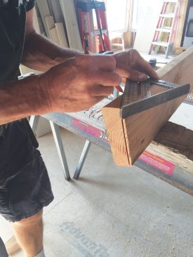

Start by cutting the plumb cut angle with the blade set to the complement of the desired bevel angle and in the opposite direction.

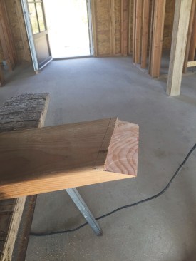

Next, scribe a line along the end cut about 1/4 inch from the short edge.

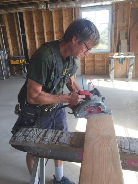

I start by marking and cutting the plumb cut angle, with a bevel the complement of the desired angle and in the opposite direction. In the photos above, I’m cutting a 20-degree bevel to get to 70 degrees. Next, I scribe a line along the end cut about 1/4 inch from the short edge (it’s OK to leave a little shoulder instead of a feather edge). After clamping the rafter up on edge, I cut along the line with the saw set square and to maximum depth, keeping the base flat on the bevel cut.

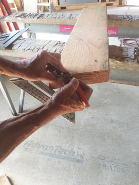

Using a straightedge, mark the rest of the cut.

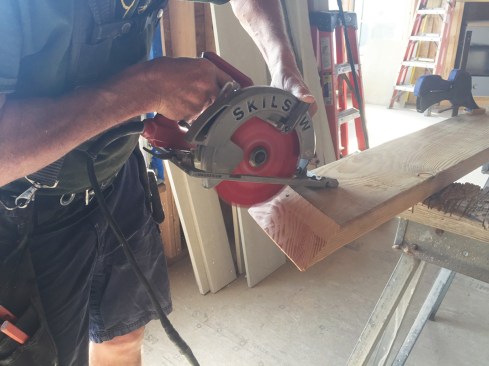

Then make a shallow pass with the saw to remove most of the waste.

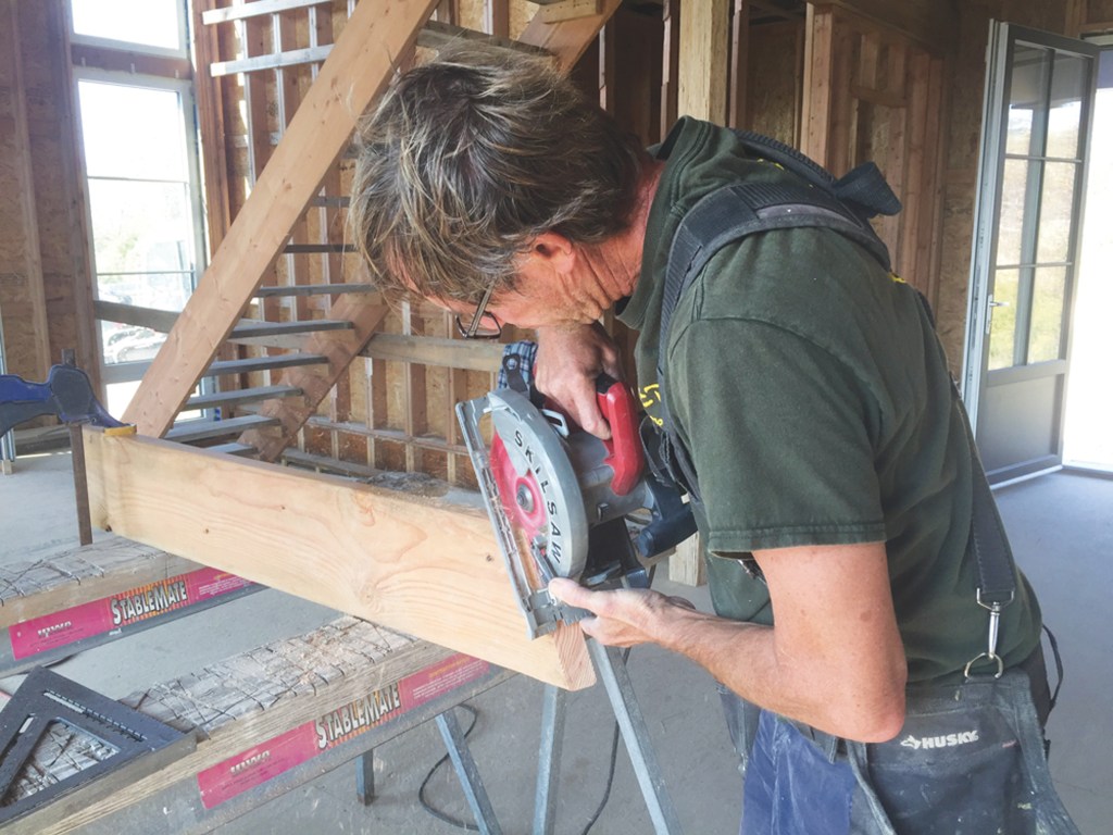

Finally, carve down to the line with a series of sliding cuts, moving the saw sideways across the face of the bevel and not taking too much off at once.
This cut won’t go all the way through, so then I mark the rest of the cut around the edges and across the other side, and rough-cut most of the waste off. Finally, holding the blade guard up, I plant the front of the base firmly on the rafter and carve down to the line with a series of sliding cuts, moving the saw across sideways and not taking too much off at once. With practice, it’s possible to make a smooth, flat surface in about 20 seconds.
