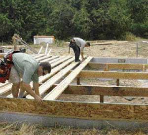

We typically split into two teams of two carpenters. One team rolls out tools and gets the floor framing material ready while the other lays out the sills. The goal is for the sill layout to be dead square and perfectly parallel.
Framing errors and compromises tend to accumulate and show up in the roof; if the sills aren’t square and parallel, the walls will follow, making the roof harder to frame. The error might even be visible when the job is done.

Installing Mudsills
Once layout is snapped, we gang up on the mudsill. If the sill is to be attached with anchor bolts, three framers mark bolt locations while one carpenter drills holes.
Anchor bolts. To locate the holes, we place the sill against the bolts, align a square with a bolt, and scribe a line across the sill at that location. We then measure the distance between the layout line (on the foundation) and the center of the bolt and make a mark that far in from the edge of the sill on the line we just scribed. The mark will be the center of our hole. It’s important to do this accurately because the hole should not be greatly oversized.
