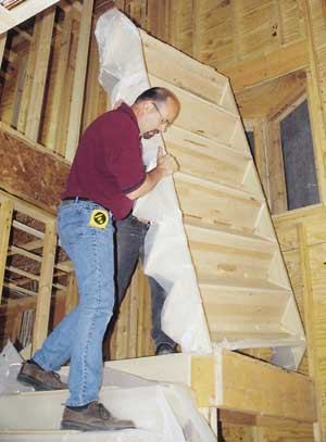

The time for installing the stairs is flexible. We always build rough stairs when we frame the house so the crew and subs don’t have to use ladders to get from floor to floor. We tear these out when the manufactured stairs arrive, which can be any time after the roof is on, either before or after drywall. Damage is an obvious concern. The manufactured stairs come wrapped in protective plastic, with tread protectors tacked on. It’s pretty safe to install them early on, but I still like to wait until most of the subs are gone — no point in tempting fate. On the installation shown in this article, it worked best to install the stairs after framing and before drywall; railings didn’t go on for another month and will be covered in a future article.
