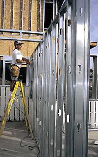

Next, we fill in the remaining studs, and header off the rough openings (Figure 1). This is a critical area, because every header has to be made up on site as specified by the engineer (). On some jobs, there might be six different header types and gauges, although we can usually reduce that number by using heavier headers than we need for some openings. This wastes a little material, but it simplifies things and saves time. Another difference between wood and steel is that steel headers are attached to the top track, with cripples extending down to the opening, rather than sitting at the top of the opening with cripples extending up to the top plate, as in a wood frame (Figure 3).
Figure 1.In steel framing, walls go up piece by piece, rather than being preassembled on the deck. Self-locking clamps hold the studs in position while the framer drives screws through the side flanges of the top and bottom tracks - the steel equivalent of the top and bottom plates - and into the studs.
Figure 3.Cripples extend downward from the header beneath the top plate, and terminate at the rough opening. Quality framing starts with accurate material. Steel won't warp or twist, but that doesn't help if the material isn't correctly sized to begin with. Cross-sectional dimensions and gauge are always consistent, but unless your supplier cuts the material to length accurately, you're in trouble. There's no problem with studs that are 1/8 inch long or so, but if the variance is much more than that the material has to be recut. Because steel framing is labor-intensive to begin with, this isn't something you can afford. Studs that are too short will fit, but they're a structural problem because a short stud is just hanging from the screws. That's not so bad in a partition, but in a bearing wall the studs must butt tightly against the top and bottom tracks. |
