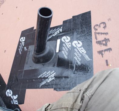

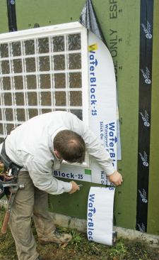

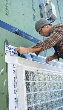

For window and door installations, we use the same basic flashing techniques with Zip sheathing that we use for walls wrapped with housewrap. The one big difference is that we’re ultimately relying on the adhesive bond between the tape and the sheathing to keep water out of the wall. First, we cover the rough sill with 6-inch Zip tape or less-expensive 9-inch Vycor or Moistop, lapping the flashing out and over the sheathing. At the bottom corners of the opening, we use either a flexible flashing tape or Vycorner prefabricated self-adhering corners (866/333-3726, graceconstruction.com). Then we caulk the back of the unit’s nailing fins with a flexible adhesive and set the window into the opening. Next, we flash the fins to the sheathing, making sure to firmly J-roll the flashing tape to the wall and nail fins. Finally, we install the head flashing over the trim at the top of the window, taping the Z-metal to the wall with Zip tape.
Huber’s 6-inch-wide Zip tape costs a little more than the 9-inch-wide butyl- and asphalt-based peel-and-stick flashing tapes we typically use, but I think it’s a far better product. We’ve left windows and doors flashed with Zip tape for over a month without a single corner or edge peeling off the sheathing (a problem we’ve had with many other peel-and-stick tapes). Unfortunately, Zip tape is approved as a flashing tape only with Zip sheathing and might be red-tagged by your inspector on regular OSB or plywood.

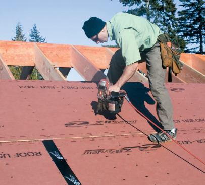

Normally, we frame roofs 24 inches on-center with 7„16-inch roof sheathing, so we have to use H-clips. But the Zip roof panels we use are true 1„2-inch OSB with a 3 2/16 span rating and they don’t require edge support. This simplifies installation somewhat but presents a potential problem: Since the long edges are self-spacing, the spacer lips on the sheathing can sometimes overlap, lifting the edge of the uphill sheet slightly. To avoid this problem, we begin nailing along the bottom of the sheathing at each rafter to pull the sheathing tight to the framing before nailing off the rest of the sheathing.
In dry weather, Zip roof panels provide plenty of traction, thanks to the grit in the overlay. The panels are slicker in wet weather, but not noticeably more so than regular OSB or plywood sheathing. In most conditions, we can comfortably frame up to about an 8/12 roof without using toeboards.

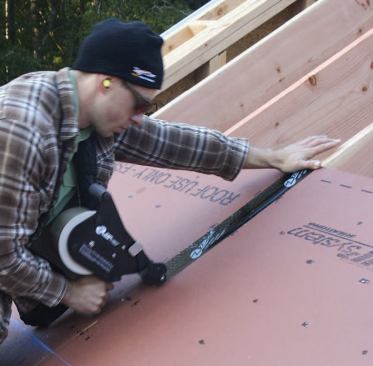

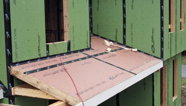

Taping. On roof pitches less than 8/12, taping roof seams is a very quick process. For example, it takes about 15 minutes to tape and J-roll a 20-foot-by-30-foot section of 7/12 roof.

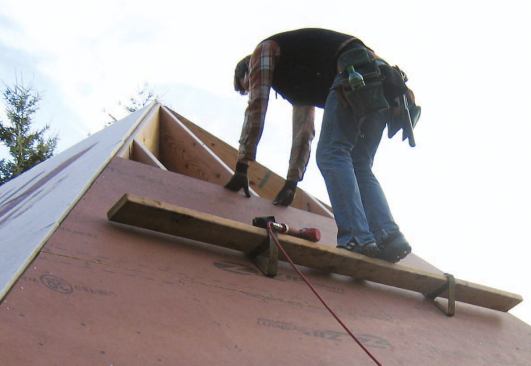

On roofs steep enough to require toeboards, however, I think that the benefits of Zip sheathing are outweighed by the extra labor required to tape the seams. On a recent 12/12-pitch roof, for instance, we needed more toeboards to get leverage on the tape gun and J-roller than we needed to actually sheathe the roof. And, of course, all of the nail holes from the toeboards have to be taped. In fact, it probably takes twice as much labor to sheathe and tape a steep Zip System roof as it does to sheathe the roof conventionally and roll out underlayment. So in the future we’ll stick to OSB sheathing for steep roofs.

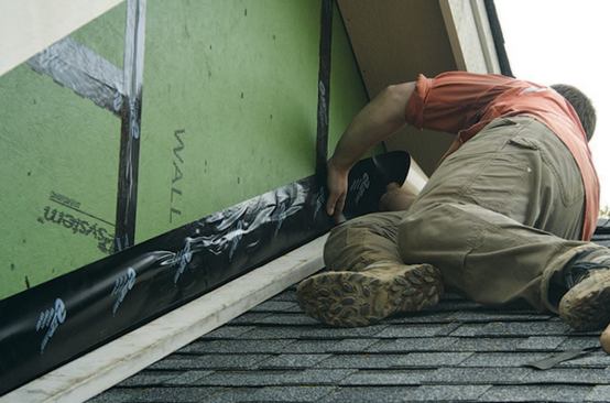

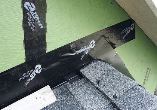

Eaves, valleys, hips, and ridges. The wider 6-inch Zip tape is ideal for valleys, though Huber says that overlapping the 3 3„4-inch-wide tape by at least 1 inch is okay, too. In some areas, code may require an additional self-adhering valley flashing. Hips and ridges are also taped, and we tape step flashings to sidewalls where necessary.
At the eaves, ice barrier membranes may be required in certain climates. They’re not required in our coastal climate, but my roofer tells me that they would be if we were building farther up in the mountains. Huber allows any self-adhering ice barrier with an ICC-ES report (or equivalent) to be used over the Zip sheathing.

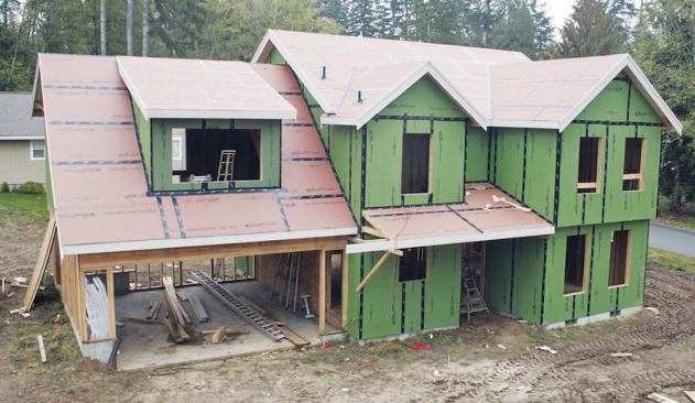

But with or without the energy savings, we’re sold on Zip wall sheathing. We can tape the walls while we’re framing and rigging them to be lifted into place, so we don’t lose any time; and we avoid the ladder work that would be needed to hang housewrap. In fact, we eliminate about a day in the construction cycle that would typically be spent installing housewrap, detailing it correctly, and then – later – fixing rips in it caused by wind or by other tradesmen stubbing pipes or wires out through the walls.
Also, since we protect the seams with tape as we frame, the panels don’t absorb moisture. This saves both time and money, since in our climate we might sometimes spend as much as $1,000 to run kerosene heaters and dehumidifiers to dry out an OSB-sheathed house before insulation.
