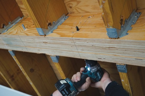

Gaps between the ends of the joists and the LVL beam ranged from 1/4 to 1/2 inch wide.

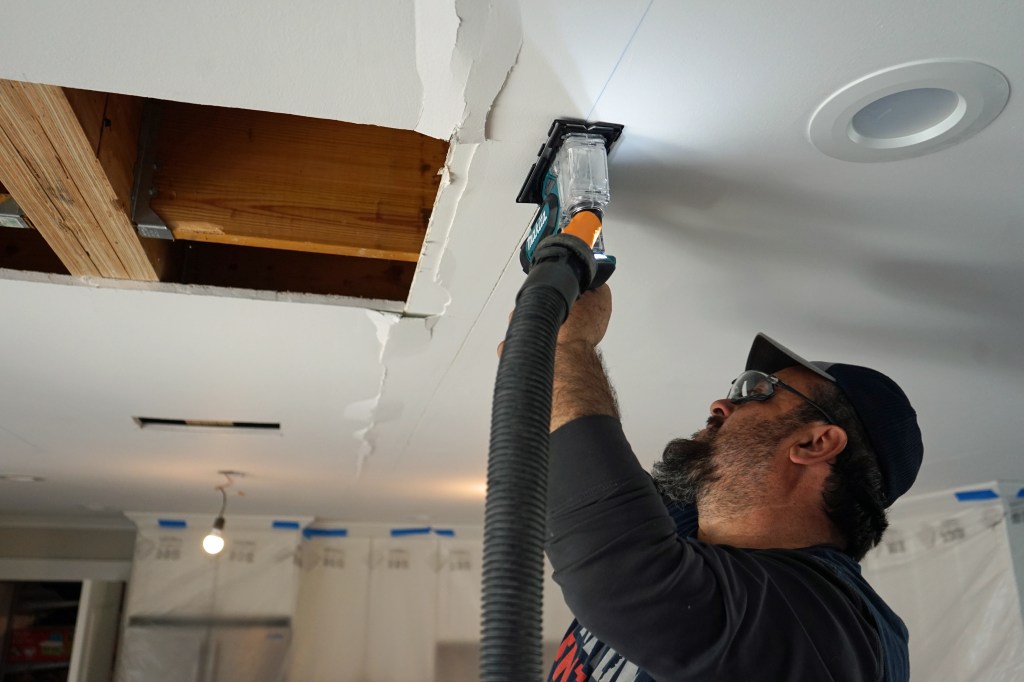

We began our investigation for the engineer by opening a hole in the ceiling. The engineer needed to verify the type and size of the concealed, flush-framed beam that had been installed during the prior renovation. It checked out to be what had been specified on the plans by engineers for the prior work—three 1 3/4-by-9 1/4-inch LVL plies. New 2×10 floor joists, which replaced the home’s original 2×8 joists, terminated into the flush-framed LVL beam.

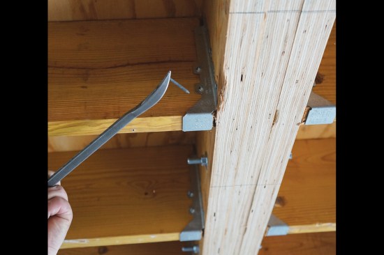

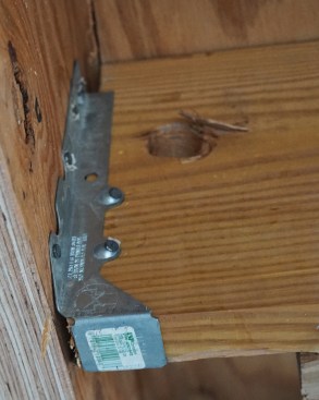

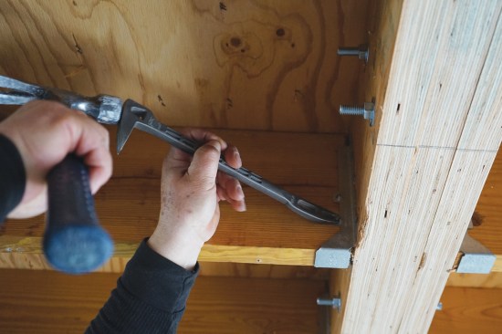

While the framing checked out, we did noticed some irregularities: Nails were missing from the face-mounted joist hangers, and many of the nails that were there had backed out. These proved to be only 1 1/2 inches long, not the 3-inch joist-hanger nails that we would have expected. On closer inspection, we noticed large gaps—from 1/4 to 1/2 inch wide—between the ends of the joists and the LVL beam (see photo, above). This is much wider than the 1/8-inch maximum allowed for code-accepted standards on face-mounted joist hangers. We speculated that the framers might have originally built the new floor expecting an undermount beam, and then switched direction when they noticed it was a flush beam. There were clear signs on the underside of the floor sheathing that the joists had been cut off with a recip saw—not what you’d expect for installing new joists.
We also noticed that one side of the LVL beam was plumb while the other side was out of plumb, suggesting to the engineer that the LVL plies had separated. And as it turned out, the LVL plies had been secured on each face only with two rows of small (3/16-inch-diameter instead of 5/16-inch) structural screws on 32-inch centers, with the rows staggered at 16 inches. That was not nearly enough fasteners for this beam, in the engineer’s estimation, accounting for one of the plies rotating out of plumb.

We began by stripping the drywall off the ceiling to expose the full length of the flush beam, opening the ceiling on both sides of the beam beyond the panel joints that had buckled.

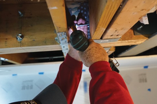

Through-bolts. With the beam and joist ends fully exposed, we set to work first on installing 1/2-inch-diameter threaded rod with nuts and bolts on each side to draw the beam laminations back to plumb. Working to the engineer’s spec, we placed these 16 inches on-center. When drawing the LVL plies together, we expected a lot of resistance from nails through the sheathing in the upstairs floor. But to our surprise, there were no nails, and the plies snugged up tight and plumb as soon as the nuts were tight.

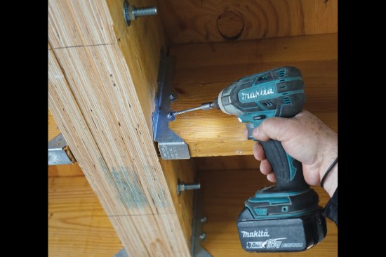

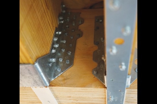

Secure hangers. Next, we backed out all the 1 1/2-inch joist-hanger nails and replaced these with 2 1/2-inch-long connector screws made by Simpson Strong-Tie. As required for all metal framing hardware, we filled every hole in the hangers.
Strap ties. The engineer specified Simpson LSTA24 20-gauge, 1.25-by-24-inch straps at each pair of joists along the beam, centered on the beam and secured with structural screws.
Compression blocks. To prevent the movement of the 2×10 joists, the engineer called for 18-inch-long 2×6 blocks nailed off with 16d nails at the top of the joists butting the beam. These blocks ran into the joist hangers and screw heads, so we had to work at getting a tight connection between the end of the block and the beam.
