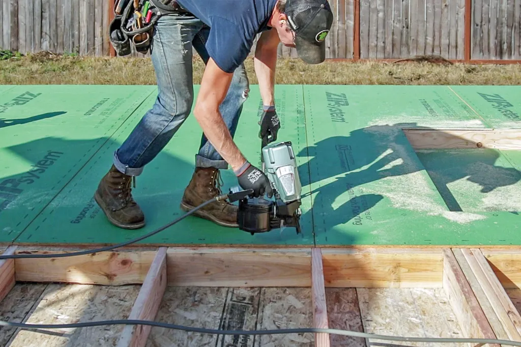

For a panel to be fastened correctly, it must be nailed off at the correct spacing and the nails set properly. The shear wall schedule provided by the designer or engineer typically includes nail size and spacing. It will specify both edge nailing and field nailing. For example “6/12” means nails are spaced every 6 inches on-center along edges and boundaries (edges of windows and doors) and every 12 inches along intermediate studs. It’s not uncommon to see 3/12 and even 2/12 on shear walls, and the schedule can vary throughout the building, so some framers will label the walls on site so it’s clear exactly how each wall should be nailed off, as shown above.
Typical nailing should be positioned 3/8 inch from panel edges and the head of the nail should be flush with the panel. It is a fact of life that not every nail will be perfectly set. In my experience, the number of overdriven fasteners can be greatly reduced by adjusting the depth of drive on the gun conservatively. I’d rather drive a few proud nails than fail a nailing inspection with too many overdriven nails.
I’ve found that there always seems to be one gun that does better than others at the same pressure. We designate that gun for sheathing.
If you have some overdriven nails, though, don’t panic. According to an APA technical brief, there is no appreciable reduction in shear capacity if less than 20% of the fasteners around the perimeter of panels are overdriven by no more than 1/8 inch . Sometimes, the panel will swell somewhat, giving the appearance of overdriven fasteners, but we find that most inspectors can tell the difference.

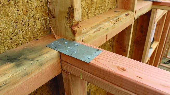

Metal connectors. All shear walls must be mechanically attached to the foundation. The plans usually specify metal straps, hold-downs, closely spaced anchor bolts, or some combination.

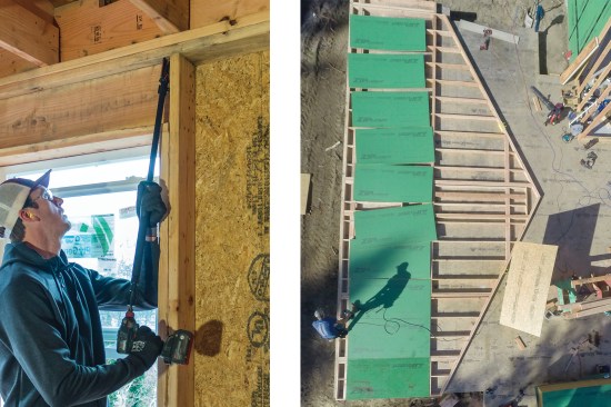

At the top of the wall, metal “hurricane” clips or structural screws are typically called for to connect the shear wall to the roof structure. Structural screws install twice as fast as a hurricane clips with a tool like Simpson Strong-Tie’s Quik Stik (see “Racing Through Rafter Connections,” in print May/19, and “Simpson Quik Stik: Like an Autofeed Extension for Setting Rafters” by Mark Clement, online).
For the required connection of a shear wall to the roof structure, the author uses a Quik Stik to drive structural screws through the top plate into rafters (above left). He typically installs shear panels on the deck before standing walls (above right) …

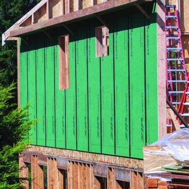

…sheathing over window and door openings and routing them out afterward (above).

The actual installation is simple. As often as possible, we sheathe our walls before standing them up (a square wall on a level floor will be plumb when it is in place). We always place panels on the center of studs and leave a 1/8-inch gap. While you can use a 16d common nail to create this space, we do it by eye because it’s faster. As mentioned earlier, the panel should say “sized for spacing.”
As you tack panels in place, make sure they lie flat. Any warping or tension in the panel can cause buckling later. The standard on my crew is to sheathe over windows and doors and rout out the openings. This is fast and clean.
