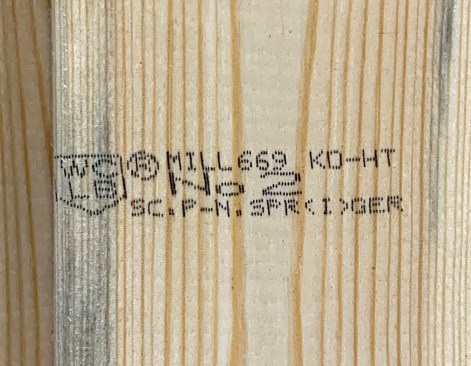

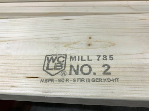

This lumber grade stamp was recently photographed on 2-by framing stock for sale at a large retail lumber chain.  The German wood species identified on this grade stamp - Norway spruce, Scots pine and silver fir - are not among the wood species currently recognized in the ICC building codes for structural applications.

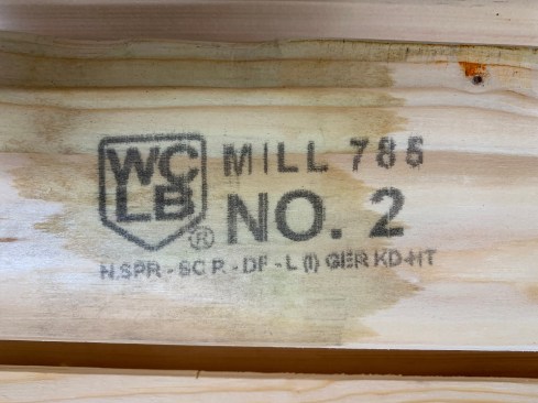

Multi-species wrinkle. Mills in the U.S. usually process wood of a single species or species group, from a single region. But imported European lumber that’s appearing in the market these days is coming from mills that process multiple species, grown in multiple regions. So, for example, wood may bear a grade stamp indicating that the lumber could be Scots pine from Germany, Norway spruce from Germany, Northeastern France, or Switzerland, or Douglas fir or European larch from Austria, the Czech Republic, or Bavaria. The mill just happens to process all those different kinds of logs.
The wrinkle is this: The various kinds of wood that are coming out of European mills may have very different structural characteristics, even if their visual grading is very similar. While a piece of wood might bear a “Number 2” grade stamp based on its visual characteristics, engineering properties such as fiber stress in bending, modulus of elasticity, or density (specific gravity) could vary widely within lumber supplies that bear the same stamp. This complicates things for engineers and code officials who are trying to design or inspect structures built with this Euro lumber.
The wood species identified on this grade stamp are woods processed at a German mill that are not among the four North American categories that the ICC building codes recognize.
As of today, the ICC codes in the U.S. don’t formally recognize all those European species and countries of origin. Tables in the IRC refer to four North American categories: southern yellow pine (SYP), Douglas fir, hem-fir, and spruce-pine-fir (SPF). Requirements in the code are based on those species and the properties that go with those species. SPF is the weakest species grouping among the eight design values that engineers use in wood building design.

The West Coast Lumber Inspection Bureau, or WCLB (as identified on this grade stamp), merged operations with the Pacific Lumber Inspection Bureau (or PLIB, as identified in Table 4G, below).

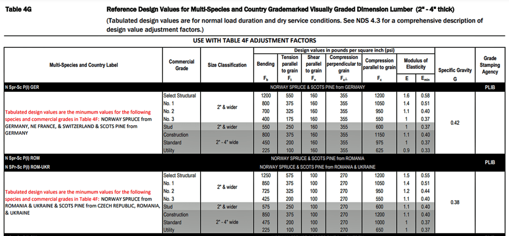

Design values have been published for the European species now appearing in the U.S. But the process of design is complicated by the mixing of species and countries of origin within one grade. To figure out the value for a given design problem, an engineer would have to look at each of the design values for each species of imported wood, and select the lowest value for any given property.
Table 4G. Some of this work has now been done for us. The American Wood Council has just released an addendum to the 2018 Edition of the Design Values for Wood Construction (a supplement to the National Design Specification for Wood Construction) that lists design values for European wood varieties (see excerpt, below). Engineers at the AWC have sifted through the design values for each of the wood species and countries of origin that have associated grade stamps, and have created combined tables that already select for the lowest value in each property.
Significance to design engineers. In many cases, the design values are lower for the Euro wood than for SPF, the weakest North American category listed in the IRC. In the case of shear wall and connector performance, the specific gravity (“G” in the table below) is a controlling factor because of its influence on fastener performance; the weaker Euro woods could result in a significant reduction in the capacity of a shear wall. Similarly, specific gravity influences the gripping strength of truss plates; weaker Euro wood could significantly compromise the strength of critical truss connections if the design software is not adjusted to take the wood variations into account. And in high-wind regions, bending strength of lumber is significant for the resistance of walls to the lateral pressure of wind.
