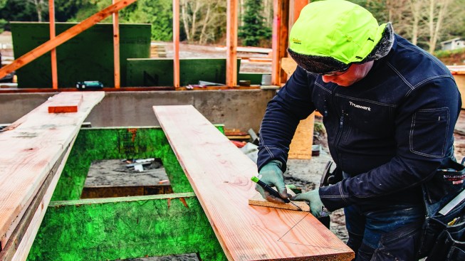

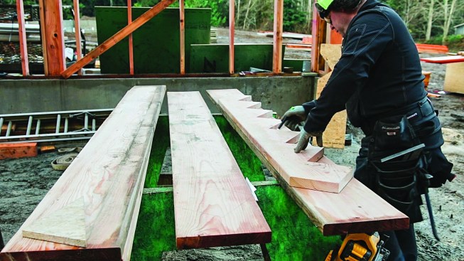

The most important thing to remember is that all the stringers must be identical. The author lays out the first stringer with a rise and run block.

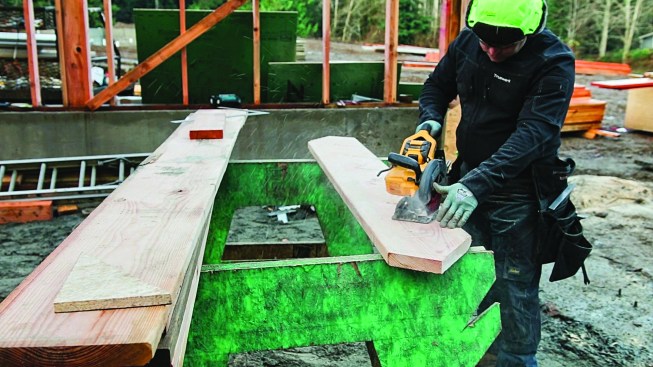

Then he cuts each step with a circular saw.

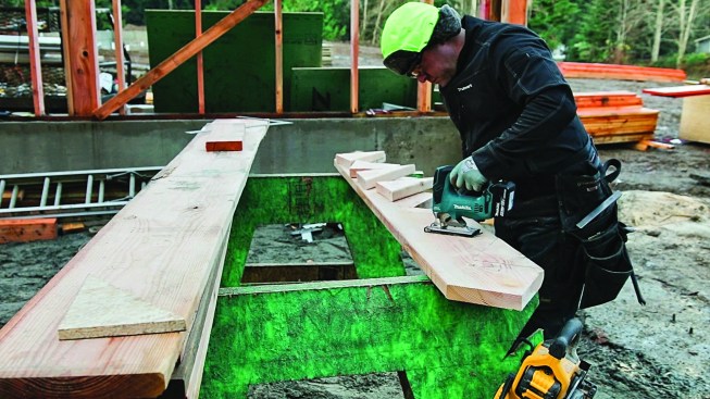

He is careful not to overcut, finishing each step with a jigsaw.
To keep stringers consistent, he uses the first stringer to lay out the second ... and (not shown) the third.
To keep stringers consistent, he uses the first stringer to lay out the second … and (not shown) the third.

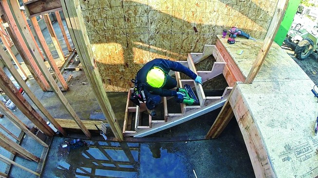

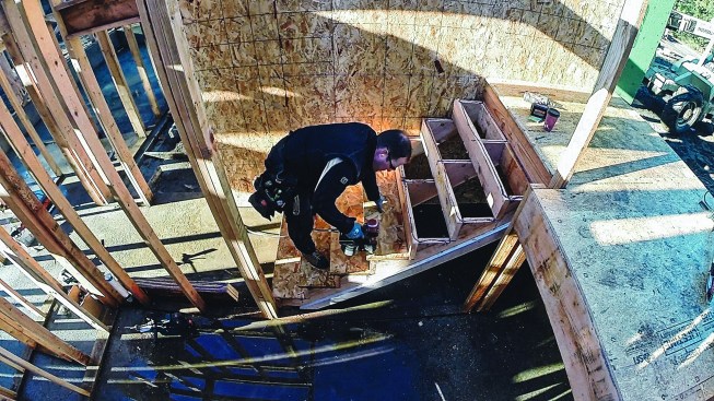

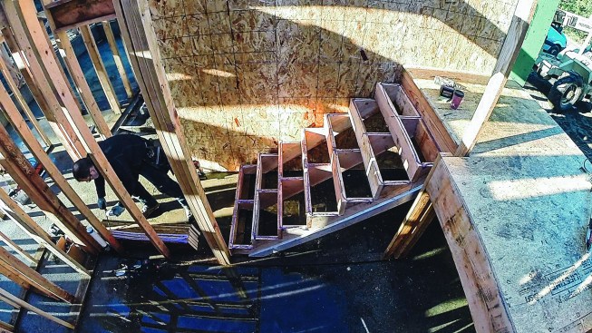

He nails on a riser at the bottom and midspan.
Then he nails on the remaining risers.

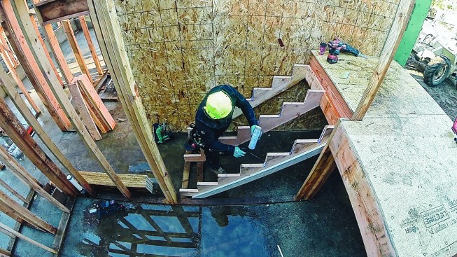

Attachment at the head. Instead of using joist hangers, I like to use full-height pressure blocks between the stringers. They provide more area for glue and for nailing for the top tread and for drywall on the underside. Pressure blocks allow me to use up all my scrap and are faster to install than joist hangers. This method also helps us minimize the number of tools we have out, since we have gotten in the habit of installing hangers with a positive-placement gun.

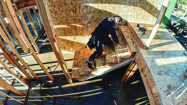

Two-by risers provide nailing for each tread. The author starts by applying adhesive to the stringer edges.

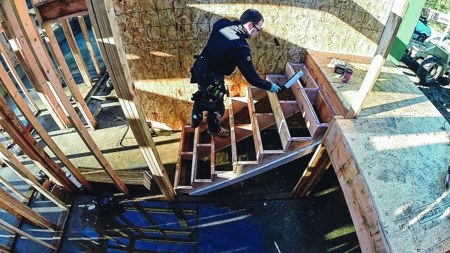

To prevent squeaks, it is important to view a set of stairs as one solid unit. I use the first stringer I cut as a pattern for the other two in that flight. Any discrepancy in size or angle will cause each stringer to act on its own and slowly loosen the parts over time. To keep the stringers as strong as possible, don’t over-notch the material. Cut right to the lines and finish the cut with a jigsaw. Cut all treads and risers and have them stacked nearby before assembling the stair.
For tread stock, the author uses Norbord’s SteadiTred OSB for consistency and durability. Here, he begins with a foamto-gel adhesive on the stringers.
He also applies adhesive to the edge of the tread that butts the riser above it.

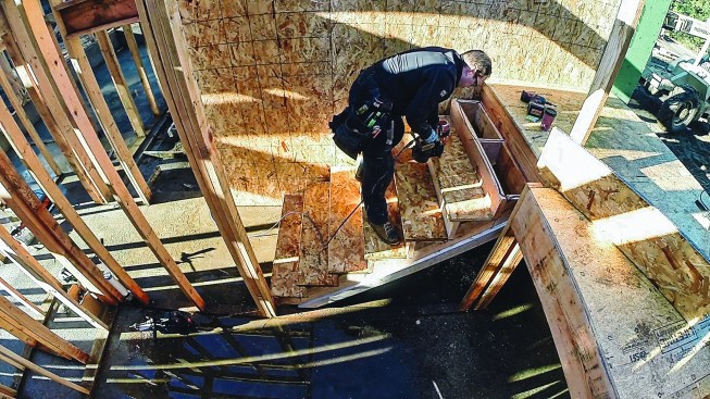

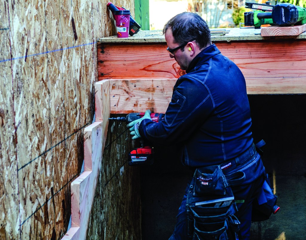

Assembly. Fasten the stringers to any walls with LedgerLok screws. This will keep them from pulling away from the wall when the wood shrinks, as it inevitably will. I don’t notch in a cleat at the bottom of the stringers, because I’ve bolted them to the walls with LedgerLok structural screws. Pressure-block the stringers at the top to keep them locked in place and to provide nailing for the last tread.

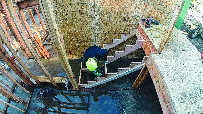

Then he nails the tread off to the stringers.

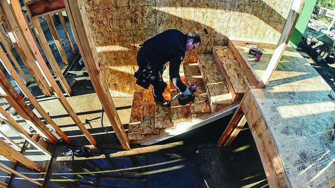

He beginns at the bottom and works his way up.
Order of assembly. I first apply glue to all the riser cuts on the stringers. I install the bottom riser, and then install a middle riser to lock in the stringers’ spacing before installing the rest. For treads, I first apply glue to all the tread cuts on the stringers and then to the back of all tread material, as shown in the sequence above.
Starting at the bottom of the stair, I nail all the treads to the stringers, working my way up. Then I mark the overhang on the tread and work my way down, nailing the tread to the riser. This spot is where we’ve most commonly had squeaks over the years; as a result, I stopped using 1-by riser material and began using 2-by. Often, the 1-by would crack over time. The 2-by riser stock allows for a better connection, and because it is stronger, it’s less likely to crack.
The riser-to-tread connection needs to be precise and strong, as it is the most likely place for a stair to squeak. After securing the treads in place, he is careful to mark the overhang.
He works his way back down the stairs, nailing off each tread to each riser.
