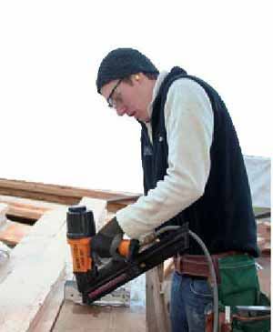

Locating Fasteners
Paslode pioneered this application with its Positive Placement tool, which uses a hardened metal probe to align the nail with the hole in the hardware. The other guns we tested allow the user to place the tip of the nail itself in the hanger before shooting (see Figure 1). I prefer the latter method; when your view is obstructed, it's easier to feel your way into the hole with a nail than with a probe.
Paslode's gun has a probe (left) that the operator uses to align the nail with the hole in the hardware.
It pivots out of the way when the gun is fired. With other guns, the nail itself can be placed directly in the hole.
