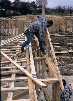

Loading strategy. The length of the building and the size of the trusses determine the best loading order. A truss that spans 30 feet and has a 4/12 pitch will only be 5 feet tall. Trusses in this ballpark, say 5 to 7 feet tall, are fairly easy to maneuver. I like to spread these out from one end of the building to the other before raising them (see Figure 1).
But if trusses are larger, say a 50-foot span with a 6/12 pitch, it ends up being too hard to move them twice. If there is room, I’d rather load these so that they can be pulled off a bundle and stood one at a time.
However the trusses are loaded, I always make sure the end trusses will be in a position that allows them to be notched for outriggers before being stood. Climbing up an already raised gable truss, with saw in hand, to cut out spaces for outriggers, is an excruciatingly slow job and is to be avoided.

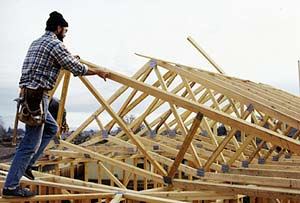

Upright end-truss braces. Before standing any trusses, temporary 2×6 braces are nailed vertically near the center of the gable-end walls to hold end trusses close to plumb while nearby trusses are raised. Avoid placing these uprights too close to the peak where they will get in the way when installing barge rafters. The 2x6s need to be long enough to reach from the bottom plate of an end wall, up along a stud, to the top chord of the end truss after it’s raised.

Before tipping a notched end-truss into place, I start 16-penny toe-nails along the bottom chord at 16 inches on-center. That way, when the truss is raised, I only have to lean over and finish driving the toe-nails as I adjust the chord flush to the edge of the wall with my foot. Raising an end truss often involves pushing on the truss studs. To be safe, it is vital to check that the studs are solidly attached before you begin to stand the truss. As a precaution, you can take this one step further and toe-nail the studs with 8-pennies to beef up the connections.
Figure 2. With the upright braces in position and toe-nails started along its bottom chord, an end truss is tipped into position and nailed off. On taller trusses, the author preinstalls the top outriggers to avoid later hassle.
While one person is holding the truss upright, another positions it by moving it back and forth until the heel intersection of the bottom and top chords lines up with the outside edges of the wall. Once adjusted to position, tack the upper chord to the upright brace and nail the bottom chord to the plate (Figure 2).
