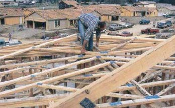

From this point on, stand and space each truss using ridge and eaves blocks at top and bottom, and the bracing layout marks along the top chord (Figure 4).
Figure 4. A carpenter nails off the top chord brace at the premarked layout line, automatically spacing the trusses. Note in the background how the outriggers have been installed in preparation for the barge rafters.

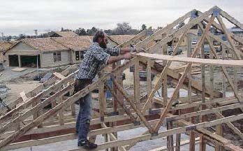

Figure 5. With the efficiency that comes from good preparation, an eaves block is installed (above), then the next truss is rolled up and nailed off (below).
At this point, I like to change gears and install the barge rafters. After the barges are hung, I continue standing the remaining trusses (Figure 5).
In a production situation, it is important to establish a rhythm and a steady pace: Stand and align a truss, nail it to the top 1×4, pull up and nail in the eaves block as well as the ceiling drywall backing, pull up another 1×4 for the next set of trusses, install an eaves vent every fourth bay. With all the trusses raised, plumb and brace the remaining end truss and install the barge rafters on that side.
