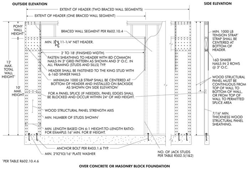

The 2009 IRC will offer multiple ways to brace walls in moderate wind-speed zones, including this updated version of the “portal frame” assembly developed by APA – The Engineered Wood Association. The closely-spaced fasteners and the extension of the header past the door opening into the sheathed wall create a stiff elbow at the corner of the frame that acts as a moment-resisting connection. Anchors and metal tie-down straps add to the strength of the assembly, and allow a narrow section of wall to effectively brace the structure. The new code is slated to be published in March 2009, but will only take effect after adoption by state and local governments.

More versatile “portal frames.” The 2006 code adopted a method for stiffening the wall area around window or door openings called a “portal frame,” which used close nail spacing and beefed-up framing to stiffen narrow walls near big openings. The 2006 version is only permitted in fully sheathed walls, but for 2009, officials have approved a portal frame method for use in walls with only partial wood sheathing. Hold-down and anchor requirements for the portal frame method have also been reduced.
