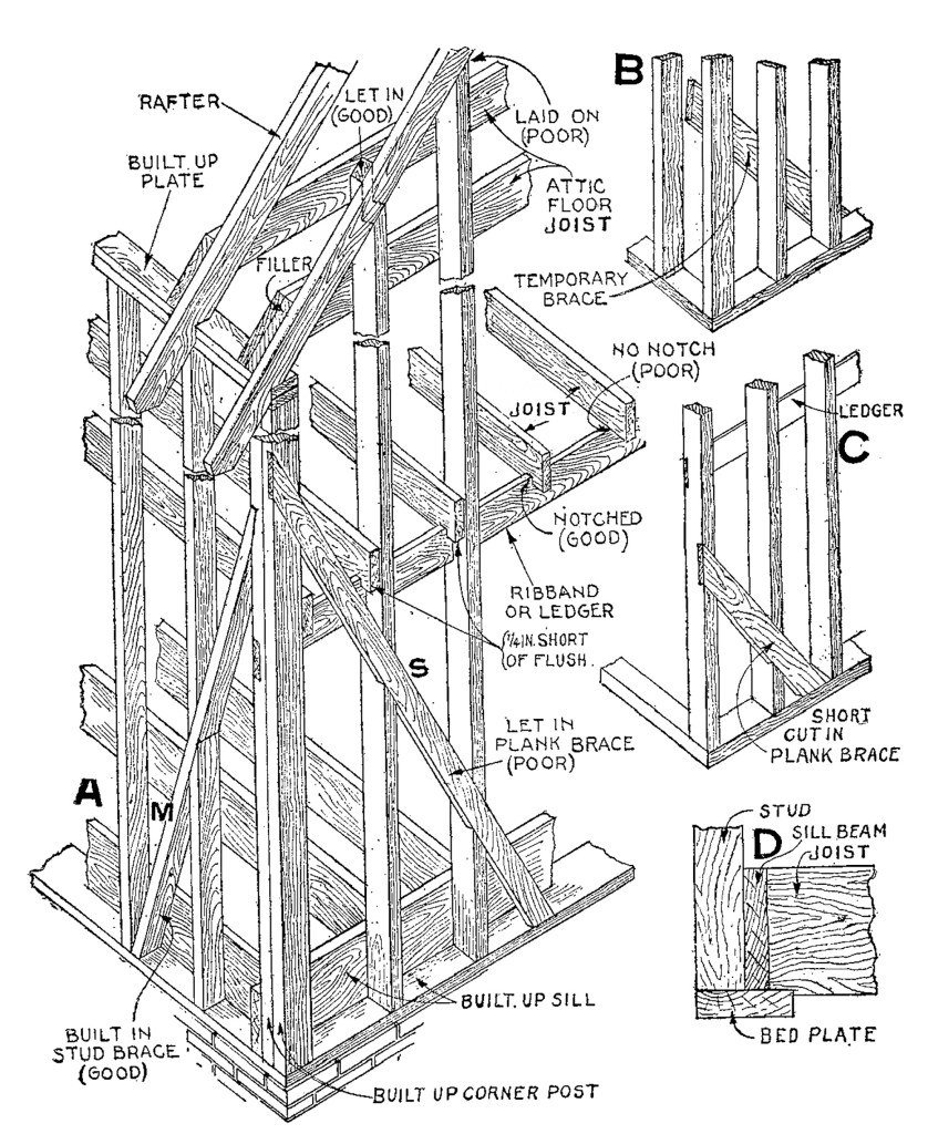

Illustration of balloon framing with building components labeled
"Audels Carpenters and Builders Guide" (1923)

In this article, I’ll start at the ground floor and move up—literally. If you’ve ever waltzed across newly framed floor joists as if one misstep wouldn’t make for a very bad day, then you’re already familiar with the chunky timbers that form the horizontal framework within houses.
Joists
English-speaking carpenters have been using the word “joist” for at least the past 650 years (before that, a joist was probably just called a “beam”). It came to English from the Old French word “geiste,” which meant to “lie down.” (Thanks to the Norman Conquest, English contains an immense number of French words.) The term makes sense. Joists are always horizontal. They are the bed for flooring to lie down upon.
