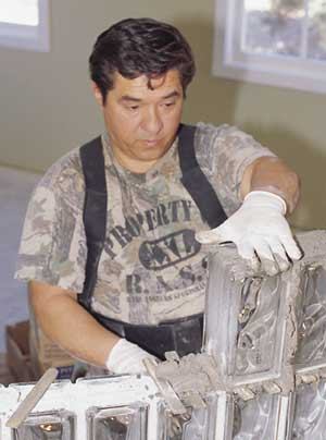

There are four steps to any glass block installation: layout, setting, grouting, and cleaning. If you need to spend a little extra time anywhere in the process, it's in the layout. If you don't get the layout right, nothing else you do will save the job. Do the math. Before anything else, measure the opening where the block is to be installed and assess it relative to the size of block you'll be using. Figure your mortar joints at 1/4 inch, and make sure your block stack comes out evenly, both vertically and horizontally, since there is no such thing as cutting glass block. If the arithmetic looks good (plus or minus 1/4 inch over 7 feet is acceptable), you can make small adjustments as you proceed. If it doesn't look like you can keep evenly spaced joints (give yourself no more than 1/16 inch to play with), then you'll have to adjust the width or height of the opening. If the opening isn't right, correct it before you begin setting block. If you have to deal with a radius, lay it out now. About three or four courses from the top you can dry-stack a column of block to figure your final corrections (see Figure 1). I often dry-set the first course to get a visual sense of what I'm working with. Remember that unlike a window or door installation, there is no such thing as shimming with glass block, so check for plumb and level on all four sides of the opening.
Figure 1. Because glass block cannot be cut, layout is crucial. Here, the author dry-stacks the last few courses to make sure he ends up where he planned.
