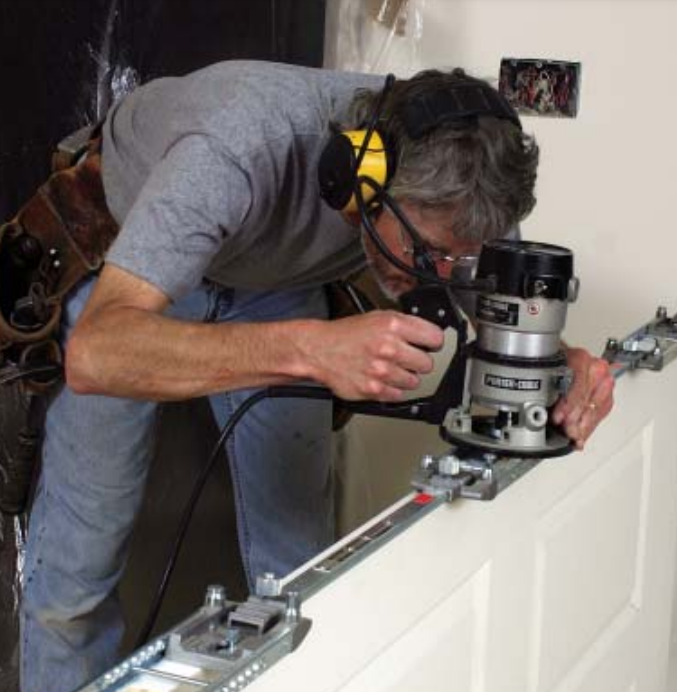

Routing the rabbet. After scribing the thickness of the head jamb on the end of each side jamb, I make another pencil mark that represents the width of the router's base plate (measured from the inside edge of the bit) and clamp a straightedge at that point.
I make a test cut on a piece of scrap to verify that my measurements are accurate and that the router's depth setting is spot-on, then I rabbet all of the side jambs one after another.

I always check the floor with a level to determine whether one side of the rough opening is higher than the other. If the jambs will rest directly on a subfloor, I simply place a shim underneath the low side. If the jambs are set directly on top of a finished floor, as they were on the job shown in the photos, I scribe the high-side jamb and cut it to fit.
I roughly center the jamb in the opening, using a homemade spreader to keep the width at the bottom the same as at the top. I then slip a pair of shims behind the bottom hinge and pin the jamb by driving a pair of 2 1/2-inch nails underneath them.
I plumb the face of the jamb with a 6-foot level, then shim and pin the top hinge following the same procedure. I don't secure the latch-side jamb until after the door is completely hung.
