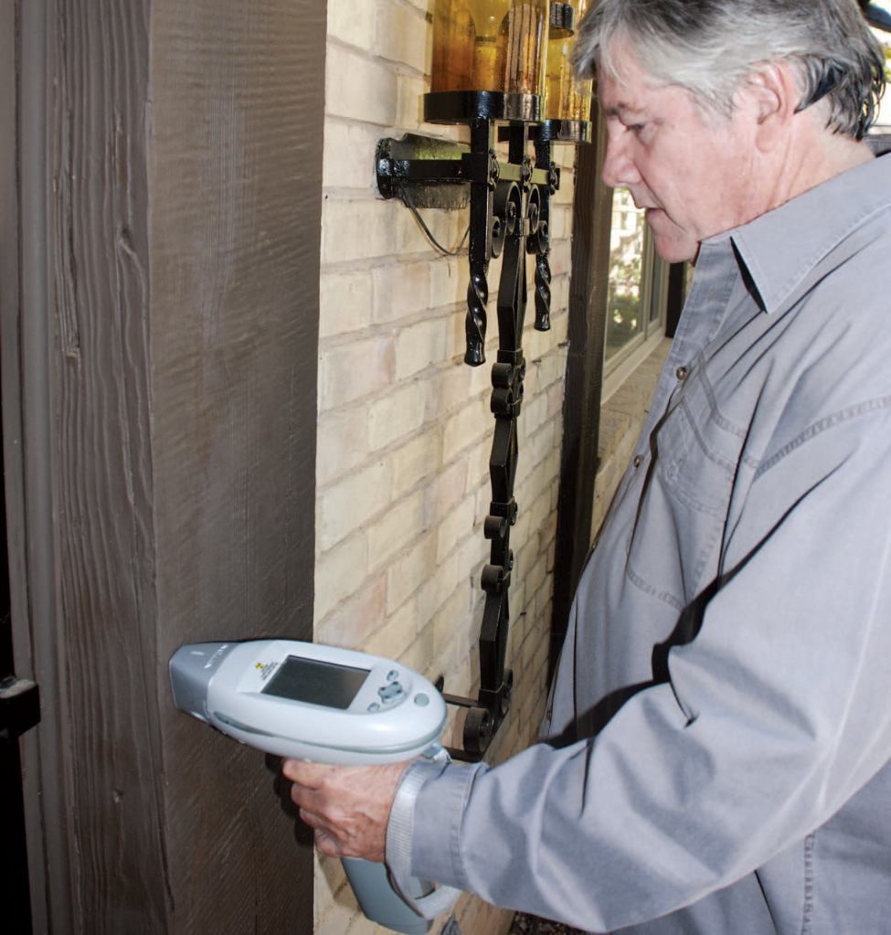

Before starting work, the author tests painted surfaces with a portable XRF analyzer to find out whether lead levels are high enough to require RRP compliance.

Basically, the rule requires that contractors contain the work area, minimize dust, and clean up thoroughly. On pre-1978 housing, you need to follow RRP work rules whenever you're disturbing more than 20 square feet of paint on the exterior or 6 square feet (per room) of paint on the interior. If you can show by testing that the paint contains no more than 1 mg/cm squared (0.5 percent by weight) of lead, the RRP doesn't apply. Otherwise, the rule requires that you do the following:
