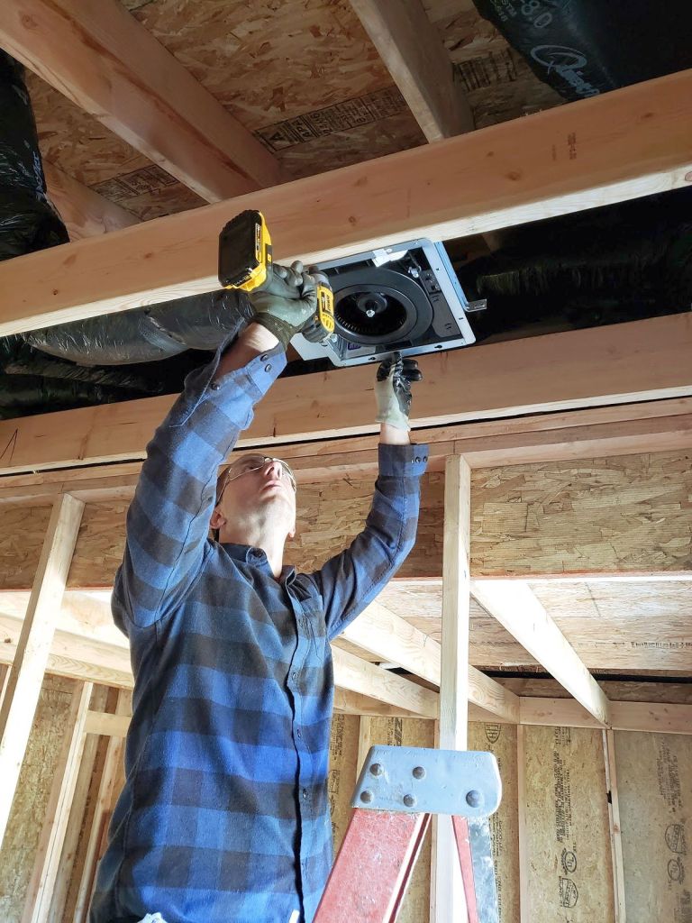

The author places a Panasonic WhisperValue fan, one of seven in the 3,800-square-foot house.

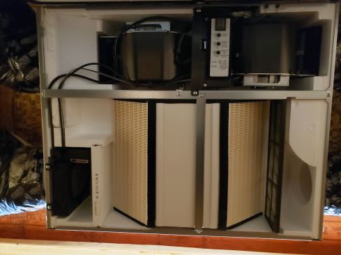

Homes that are tighter than 3 ACH50 require mechanical ventilation, based on the options that we choose from tables in the Washington energy code. To meet this criterion, we typically install a Panasonic Intelli-Balance 100 ERV, which can be adjusted to provide between 50 and 100 cfm (cubic feet per minute) of supply and exhaust airflow.

The inside of the Intelli-Balance 100 ERV is shown above. External controls on the unit allow the installer or owner to set the intake and exhaust airflow independently, allowing the house to be placed under a slight positive or negative pressure if desired. The unit accepts either a MERV 8 or a MERV 13 filter.
One interesting wrinkle with the Intelli-Balance 100 is that the airflow speed of its intake and exhaust fans can be independently set using dials on the outside of the unit, in a range from 50 cfm up to 100 cfm. This means that the home can be set up to operate at either a positive or a negative pressure. In this house, we set the fan for supply-side inflow to be slightly higher than exhaust-side outflow. The idea is that this will compensate somewhat for times when the point ventilation exhaust fans are running; the rest of the time, the house will operate at a slight positive pressure.

At Pioneer Builders, we have had a good experience with Panasonic fans. From its products, we select the options for each fan according to the room it will operate in.

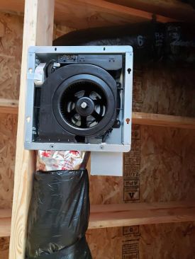

A look inside the housing of the Panasonic WhisperValue fan shows the controls that allow the installer to select an exhaust airflow of 50, 80, or 100 cfm (above). The relative humidity set point of the room can also be dialed in for the condensation sensor.
We’ve found Panasonic WhisperValue fans to be excellent fans to use. These fans are low-profile, and they are UL rated for ceiling or wall installation. While we’re a new-construction, single-family residential builder, these fans would work well in retrofit or remodel situations as well. Remodelers who run into situations with shallower studwall cavities or ceiling joist cavities may find that this fan fits the bill. The fans’ low profile may also be valuable in a multifamily situation where you don’t want to penetrate a fire-rated ceiling.
The motor is an ECM (electronically commutated motor) that is engineered to run continuously. The motor increases the fan speed automatically when the unit senses static pressure, to maintain the selected cfm. The more bends in ductwork, the more difficult it is to push air through it. The fact is, not all ducting ends up being perfect, so having a fan that adjusts to real-world conditions is a valuable feature.
Another feature of these fans that we like is the manual adjustability of the fan speed. While there is a more powerful model, we typically install the one that can be set at 50, 80, or 100 cfm. We set the fans to 50 to begin with, which is the quietest setting, but also moves the least air. As part of our home-selling package, we include four visits to the homeowners for the first year after purchase, and one of the things we check is how happy they are with their fans. For example, if they aren’t moving enough air out of the bathrooms quickly enough, we can increase the speed. At any cfm setting, these fans are very quiet: The noise created varies in a range from less than 0.3 sones (at 50 cfm) to 1.3 sones (at 100 cfm). They’re also energy-efficient: The cfm per watt for the fan operation can range from 7.2 to 12.8.
Like other fans in the Panasonic lineup, the WhisperValue is a versatile brand. You can buy the basic model, which is only a fan, or you can add in several practical modules including an LED (light emitting diode) light, an LED night light, and a condensation sensor. The option that we are most likely to include is LED lighting. Depending on the size of the room and the height of the ceiling, that may provide sufficient light for the room. Note that the color temperature is 3,000 Kelvin, so you may want to take that into consideration when specifying lamp colors for additional fixtures located near the exhaust fan.
Another option that we specify depending on the room is a condensation sensor. We select units with sensors for high-humidity rooms, such as a bathroom with a shower or bathtub.
