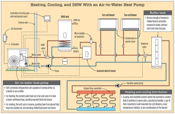

Pieces of the puzzle. The schematic above shows the primary components of a typical air-to-water-heat-pump setup. There are many ways to configure a system, but in this example, the outdoor system provides heated or chilled water to satisfy three types of demand: domestic hot water, a radiant floor, and a pair of wall-mounted fan-coil units that can cool as well as heat.

So what are air-to-water heat pumps, and how do they work? The principle is simple: A self-contained refrigeration unit capable of running either as a heater or as a chiller sits on a pad on the ground outside a building. When heating is called for, the system pulls heat out of the air and uses it to heat a water-antifreeze loop, sending the warmed fluid into the house. When the house calls for cooling, the unit runs in reverse, pushing heat from the glycol-fluid loop into the outdoor air and sending the chilled fluid back into the home.
Inside the house, a buffer tank stores enough of the heated or chilled fluid to smoothly respond to loads, without start-and-stop hiccups. A pump-and-manifold system sends the warmed or cooled fluid to emitters, which could be a warm slab, a ducted air handler, a set of floor-mounted or wall-mounted fan-coil blowers, a low-temperature radiator, or any combination of the above. In winter, the warm slab and the hydro-air blowers or radiators heat the house; in summer, the blowers and perhaps even a chilled slab cool the same spaces. Systems can also be configured to heat domestic water.

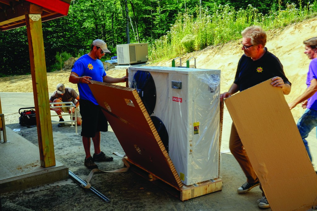

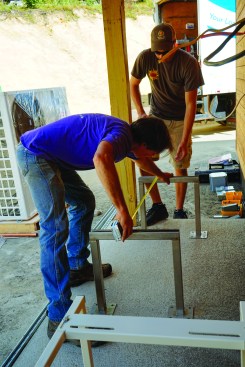

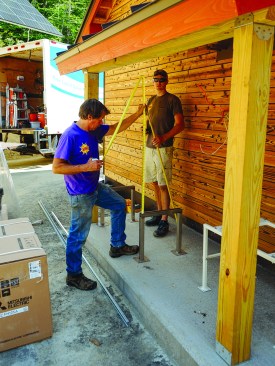

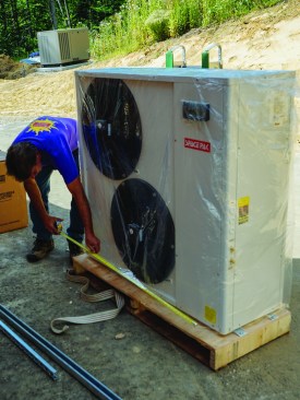

Workers for ReVision Energy install a SpacePak air-to-water heat pump at a custom home in southern Maine. ReVision’s Chris Blaisdell checks the unit’s dimensions.
Then he checks the headroom and support frame width.
All the refrigerant in the system is contained within the package unit, but planning and coordination are needed to make sure the pad is correctly sized and power hookups and shutoffs are appropriately located.

The muscle of an air-to-water-heat-pump system is the outdoor unit, a self-contained compressor, condenser, and evaporator that can produce either heated or chilled water. For builders, installers, or even do-it-yourselfers, one big advantage to this concept is that all the refrigerant for the system is contained inside the package unit. Installers just have to place the unit and hook up the hot and cold water-antifreeze loops, which, unlike handling refrigerant, requires no special license from the Environmental Protection Agency (EPA). Seattle-area builder Ted Clifton, who handles his own installations, comments, “With refrigerant, there’s a little bit of a hazard. You don’t want to let that leak out into the air; you have to be careful. But running just supply and return water lines, it’s no big deal. You could even puncture one of those and it’s not going to cause any big problem besides a leak.”
In a typical installation, the fluid from the outdoor unit is pumped to a buffer tank inside the house. This simplifies the control system. The chiller on its pad outside senses the temperature in the buffer tank and keeps it constant. Loops drawn off the buffer tank serve the heating and cooling output devices in the living spaces; if the house calls for heat and those supply loops activate, the temperature in the buffer tank changes, which signals the heat pump to kick in and restore the balance.
Next in the chain are the emitters. In this regard, houses we looked at in researching this story turned out to be similar. Each well-insulated home had a radiant slab on the ground floor. Besides the heated slab, all these homes also had some sort of hydro-air point heat source to heat upstairs zones or to provide cooling in summer, or simply as a quick-response supplement for the main heated slab.
Heat pumps provide relatively low-temperature water. That’s ideal for radiant slabs; 95°F hydronic fluid in the slab is typical. Depending on the setup, the small hydro-air fan-coil units that serve some rooms or zones can be supplied with 120°F to 130°F water if needed; the fan-coil units, however, are also designed to squeeze useful heat out of lower temperature water in a way that ordinary radiant baseboard can’t. Higher water temperature allows higher heat output per hydro-air emitter, but lower-temperature water allows the emitters to operate more efficiently.

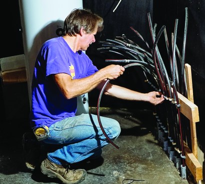

ReVision Energy’s Chris Blaisdell works on the hydronic tubing for a radiant slab in a
custom house. Behind him is the hydronic buffer tank for the system.
ReVision Energy’s Chris Blaisdell works on the hydronic tubing for a radiant slab in a custom house. Behind him is the hydronic buffer tank for the system.

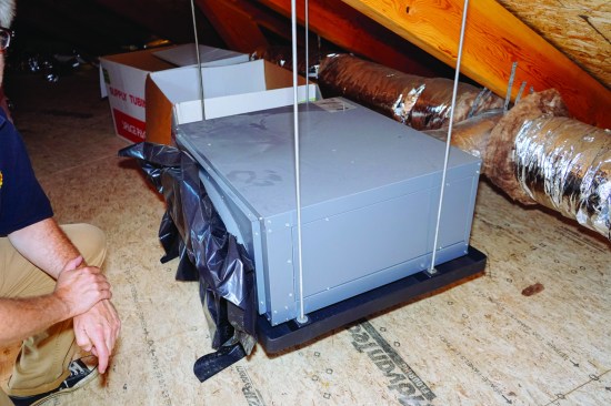

On the second floor of this home, a SpacePak high-velocity hydro-air unit will supply heated or cooled air using fluid supplied by the same outdoor-mounted heat pump.

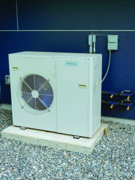

The outdoor heat pump unit

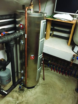

The buffer tank
The buffer tank

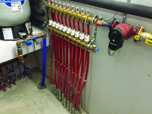

A hydronic manifold for the heated floor

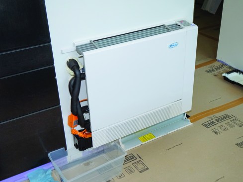

A wall-mounted hydro-air emitter
