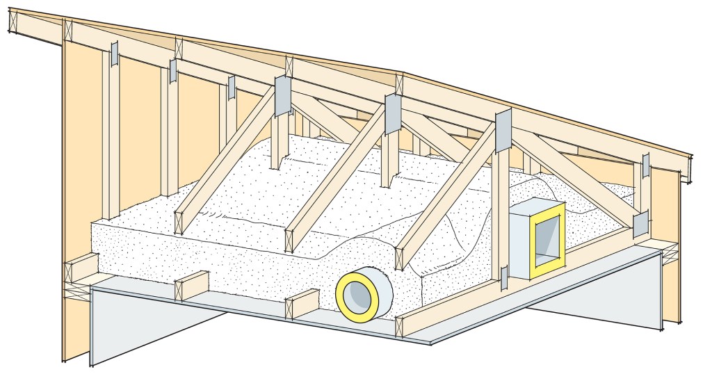

After working on the idea with builders, contractors, and industry experts, Drumheller proposed a code change at an International Code Council (ICC) meeting, and the council voted to accept it. Starting with the 2018 IECC, buried ductwork will be explicitly allowed in the attic. If you’re following the performance path, your calculations can treat buried ductwork as being insulated to R-25, as long as it’s covered by an R-19 layer of insulation in addition to the R-8 duct wrap. And if you meet a strict duct airtightness criterion (1.5 CFM25 of leakage per 100 square feet of occupied space), you can even consider the ductwork as equivalent to ducts located inside the conditioned envelope of the building.

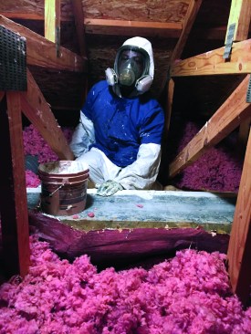

An Edge Energy installer seals a trunk line in an existing home before burying the duct with blown cellulose—a safe and routine practice in mixed climates, says Gary Boyer.

Gary Boyer, an energy rater with home performance contractor Edge Energy, says his field experience in Maryland and Virginia is consistent with those research results. In retrofit work, Edge Energy crews routinely seal ductwork with mastic (or, if the ducts are not accessible, using the Aeroseal latex aerosol process), then bury the ducts under a deep blanket of blown cellulose insulation. Says Boyer, “I have yet to see a low-lying duct that is buried in insulation that has had condensation, either in the retrofit or in the new-construction areas.”
But Maryland is not Florida—and in considering the building code amendment, the ICC took the elevated risk in hot, humid climates into account. Under the new provision, in climate zones 1A, 2A, and 3A—which covers most of the Southeast, including Florida, Georgia, Alabama, Mississippi, and South Carolina—ductwork will have to be insulated to R-13 if it’s buried under insulation. “If we go to R-13 in the hot-humid climates,” says Drumheller, “it will push the dew point far enough out that there shouldn’t be any significant condensation.”

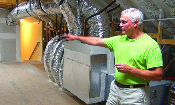

Contractor Curt Kinder in the encapsulated attic of a custom home in Jacksonville, Fla. Compared with ducts buried under blown insulation, the “civilized space” of a sealed attic allows easier maintenance and quality control, argues Kinder, and makes the area under the roof available for storage.

Not everyone is convinced. Jacksonville, Fla., air-conditioning contractor Curt Kinder is a skeptic. First of all, Kinder points out, there’s currently no such thing as R-13 duct wrap or R-13 duct board. “The only reason we can even buy R-8 flex duct here is because it’s required across the state line in Georgia,” he says, “and even so, it’s hard to get.” The Steven Winter Associates’ Jacksonville study used spray-applied polyurethane to achieve the specified R-13 duct insulation level, but as Kinder notes, that approach introduces a whole new trade coordination, scheduling, and quality-control problem.
“R-13, successfully implemented on the ducts themselves, passes the ‘sniff test’ for me,” Kinder says. “But foam encapsulation seems difficult to ensure in the field. Foam guys have enough problems with simple planes—how are you going to ensure consistent coverage under ducts?” (And in fact, even in the Steven Winter Jacksonville pilot study, researchers noted thin coverage on some elements of the ductwork assemblies.)
Kinder points out non-energy benefits to his preferred approach of sealing the entire attic with closed-cell spray foam on the roof underside: “Additional strength, an improved vapor barrier, civilizing the volume for storage, reducing outdoor contaminants, and preventing pest entry.”
