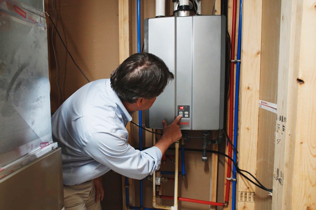

Man inspecting Tankless Hyrdronic heater

Hydronic air handlers, sometimes referred to as water furnaces, provide space heating by using a hydronic heating loop to heat air as the blower moves it into the home. Tankless water heater manufacturers such as Rinnai have recently launched air-handling units and controls designed specifically to work with tankless units, which overcome some design challenges and provide several advantages. Tankless water heaters designed to work with a paired system such as Rinnai’s offer reliability and thermal efficiency, with condensing units achieving efficiency levels up to 94 percent. And because they heat water continuously on demand, there’s no need to worry about running out of domestic hot water.
In furnace replacement scenarios such as McCoy’s, installing the tankless unit can be extremely straightforward because the furnace’s gas line and ventilation can be reused. “For an installer of the system, it could save up to 2–3 hours of time installing it by not having to do your venting or additional gas lines,” says Kelley, who performed McCoy’s installation.
The tankless water heater also allows for a very compact installation, creating space savings by eliminating the need for a separate electric or gas storage tank water heater. “Approximately 200 cubic feet of space was saved in my situation,” McCoy says. “So that same 200 cubic feet could be used in new construction to add a closet or simply reduce the size of the structure. With building material prices escalating like they are, it could save some money in new construction.”
