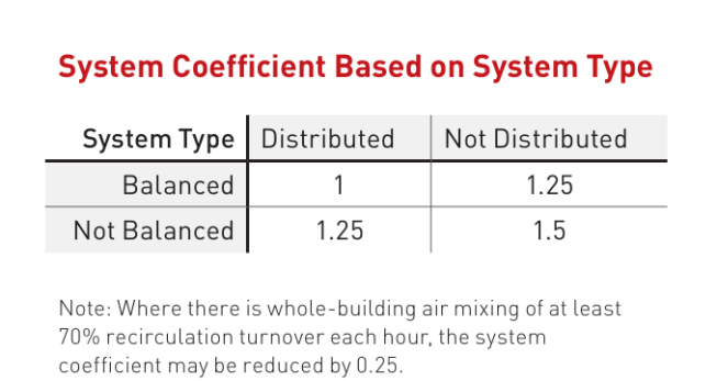

So, Lstiburek introduced his own standard, which he calls BSC-01. It’s not a standard in the same sense as the ASHRAE Standard because it hasn’t gone through any kind of consensus process and isn’t ANSI certified. BSC-01 is more like a set of guidelines or recommendations informed by Building Science Corp.’s vast experience with those tens of thousands of new homes it consulted on.
The BSC-01 base ventilation rates are the same as the 2010 version of ASHRAE Standard 62.2, so that a 2,500-square-foot, 3-bedroom house would have a base rate of 55 cfm. With a balanced ventilation system that distributes the air throughout the house, that’s how much Lstiburek says you need (1 x 55). If you also mix that air, you can cut that by 25%, so with a system that balances, distributes, and mixes, you’d need only 41 cfm (0.25 x 55, per table footnote). If the system had none of those qualities, this house would need 83 cfm (1.5 x 55).
The BSC-01 base ventilation rates are the same as the 2010 version of ASHRAE Standard 62.2, so that 2,500-square-foot, three-bedroom house would have a base rate of 55 cfm. But—and this is the crucial part—that base rate is modified by how much the ventilation air is distributed throughout the house, balanced between exhaust and supply, and mixed with the other air in the house. The table (above, left) shows how it works.

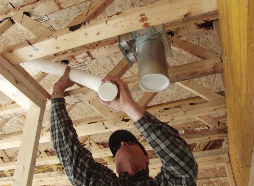

Next, you must figure out what type of supply-only ventilation system you want to install. You have three options: standalone supply, central-fan integrated supply (CFIS), or a ventilating dehumidifier.
The standalone supply ventilation system uses its own fan to bring outdoor air into the house. To do it without comfort complaints, you’ll need to temper the outdoor air before introducing it into the house, which you can do by mixing it with indoor air.
The illustration shows one version of this. The more you pull indoor air from different locations and deliver the mixture to more locations throughout the house, the less likely it is that occupants will feel the temperature difference of the incoming air. That’s a good strategy because the less the occupants notice the system, the more likely it is they won’t turn it off.
