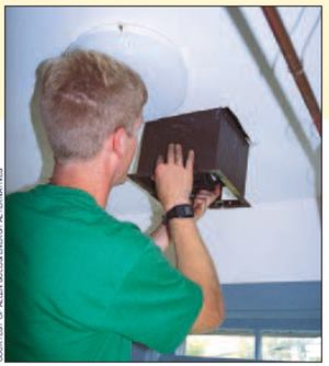

Bathroom exhaust fans are what we typically do. But a few point source exhaust fans is typically not enough to provide adequate whole-house ventilation. The goal of whole-house ventilation is to provide balanced ventilation that is well distributed and mixed with the air throughout the house.
