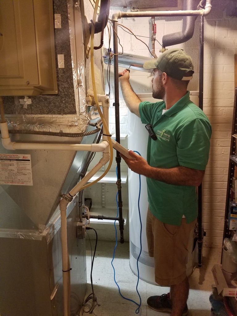

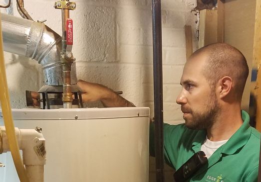

The author uses a manometer probe to test the draft pressure in a water heater vent. This step should be performed routinely for safety and quality assurance any time the mechanical room equipment is serviced, and whenever weatherizing work or remodeling may have affected combustion appliance vent performance.

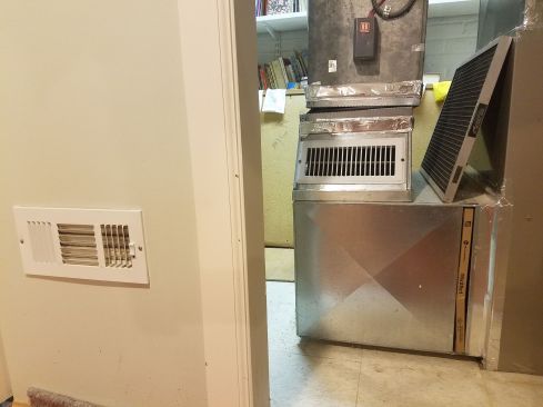

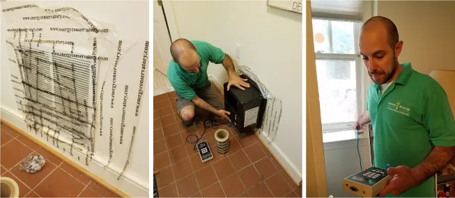

When the HVAC contractor described this backdrafting water-heater situation to me over the phone, I was pretty sure I knew what I would find at the house. The basement had been recently remodeled, and there was a large return grille in the finished space connecting through the wall of the mechanical room, with a large, short run of duct straight to the air handler. I expected to find out, as I have in other, similar cases, that the oversized return was depressurizing the basement enough to backdraft the water heater.

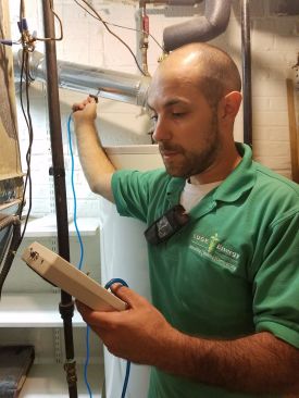

To find out, I started by conducting a standard “worst-case” depressurization test. We measured the air pressures throughout the house. If a room had positive pressure, we closed the door to shut it off from the rest of the space. If it had negative pressure, we left the doors open. We turned on every fan that could create a negative pressure in the house: dryers, bath exhaust fans, and the recently installed kitchen downdraft vent. Under those conditions, the air pressure in the mechanical room dropped to -3.8 pascals (Pa)—and sure enough, the water heater began to backdraft.
The author suspected a large hvac return duct of backdrafting a water heater. But masking off the return (left) had little effect. Measuring the airlow through the grille (center) revealed that the return flows were acceptable. Finally, room air pressure measurements (right) established that an upstair kitchen range exhaust was the true culprit.

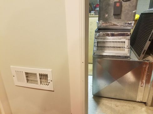

Next, I tried to eliminate my chosen suspect: the return grille. I taped off the grille with 6-inch-wide tape from Energy Conservatory, expecting the problem to go away (this is the tape we commonly use for airtightness testing—it holds well enough, but you can pull it off without damaging paint).
But I was wrong. Basically, nothing happened: The water heater continued to backdraft, and the pressure in the mechanical room increased by only about 0.2 Pa.
So next I asked the HVAC contractor to go upstairs to the kitchen and turn off the downdraft fan on the range. “Don’t tell me before you do it,” I said. “Just do it, and I’ll watch the manometer.”
Sure enough, a minute or two later, the manometer reading changed to about -0.6 Pa. Of the -3.8 Pa depressurization, about -3.2 Pa was caused by the kitchen fan.
Still, I was glad I had gone to the trouble of investigating all possible causes, even if some turned out to be dead ends. The obvious solution when you have a backdrafting problem is to replace the natural-draft appliance with a power-vented unit. And in the end, that’s what I recommended. But it was worth it to look more closely. If the duct return grille had been to blame, the problem could have been fixed by just reducing the size of the return in the basement, and perhaps increasing the size of the upstairs returns, which would have been a less expensive fix.

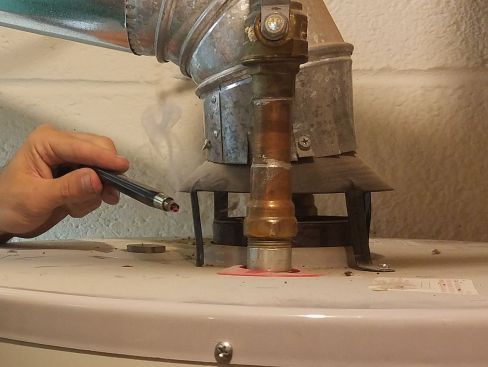

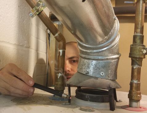

And in fact, a worst-case depressurization test of the mechanical room did induce obvious backdrafting of the water heater. Photos in the slideshow at left show me using a smoke pencil to reveal the backdrafting, but the problem was also evident when I held a mirror next to the flue, and the moist exhaust fogged up the glass. In fact, I could feel the gas like a hot breeze against my face without any equipment at all.
In this case, the air-conditioning return ducts and grilles—the usual suspects—did turn out to be the root of the problem.
Because the supply registers in the house weren’t delivering enough heating and cooling (especially at the furthest reaches of the duct runs), the homeowners had sealed up the supply ducts in their basement with tape and mastic. But they didn’t know enough to seal up the return ductwork also—they didn’t realize that by sealing only the supply ducts, they were changing the air pressure in the mechanical room and creating a negative pressure that would affect the water-heater combustion vent.
It’s not clear who added a whole return grille to the system right in the mechanical room, when the return outside the mechanical room door would have been sufficient. But in combination, the two return vents created a suction that completely overpowered the natural draft in the water-heater flue.

I had taped over the return grille with Energy Conservatory tape as part of my pressure testing, and I advised the homeowners to make that fix permanent with the same tape and mastic they had used on their ducts (and to seal the return ducts too).
