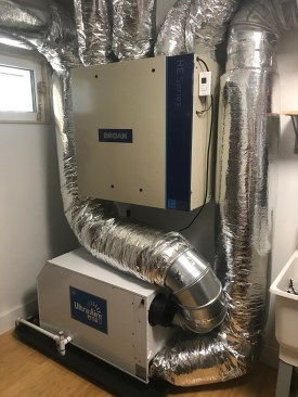

Most ERVs like this one (upper piece of equipment) have ports for standard 4- or 5-inch ductwork. Note that this system includes the indoor coil (lower piece) for a dedicated dehumidifier, which will be needed in most locations to address latent loads.
It is also crucial that the hygrothermal gradient—meaning how hot/humid it is on either side of the ERV core—be considered in your approach. An ERV will not effectively exchange enthalpy if there is not a dry/cool air mass on one side of the core media. In humid climates, this means you’ll need a dedicated dehumidifier to handle latent load, especially in shoulder seasons where there isn’t much dry-bulb load to deal with. Beyond the obvious implications for poor indoor air quality and material durability, I’ll explain why else this is important later.
