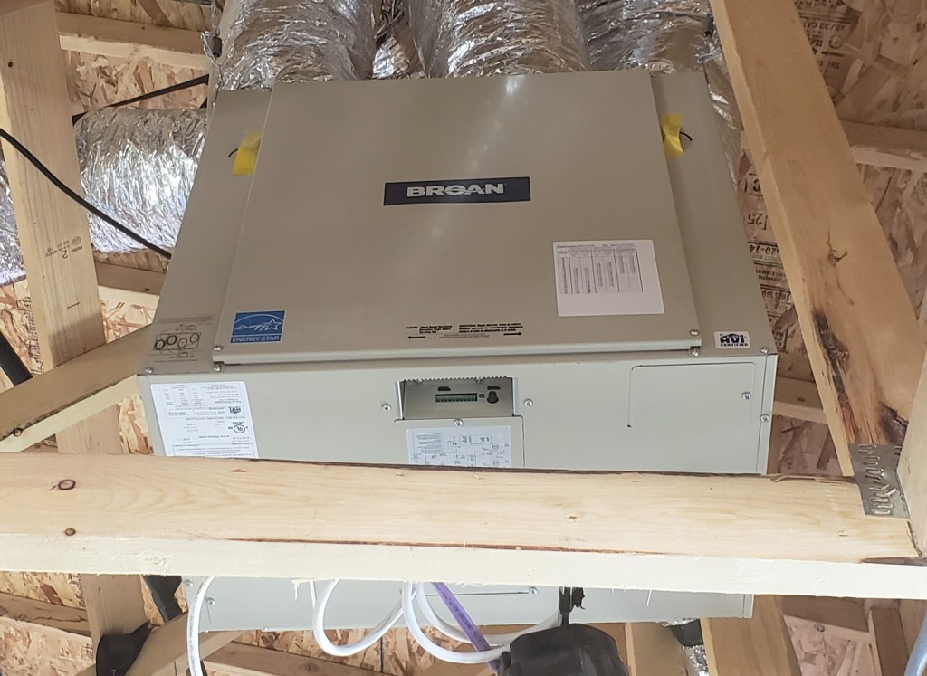

When it comes to sizing an air conditioner, you’ve no doubt heard that it’s a bad idea to install a system that has more capacity than the house needs. That’s not true, however, when it comes to sizing an energy recovery ventilator (ERV) or heat recovery ventilator (HRV). Oversizing, in fact, can be a good thing. But we can’t talk about oversizing an ERV (from here on out, I’m going to use “ERV” but it applies to HRVs, as well) without first having a reference point, a size above which the ERV might be considered oversized.
Unlike with a heating and cooling system, oversizing an ERV is not a problem, and even preferred. More ventilation is often better as long as it is balanced and recovers some heat and moisture.
Geoff Ferrell/Mandalay Homes

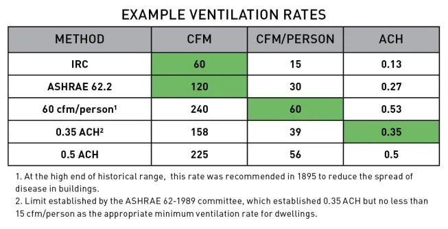

Using those two formulas, we can calculate that a 3,000-square-foot house with three bedrooms would need 60 cfm under the IRC rule and 120 cfm using ASHRAE 62.2. Another way to look at the ventilation rate would be in terms of airflow per person. With the four hypothetical people in this house, the IRC calls for 15 cfm per person; ASHRAE 62.2 for 30 cfm per person. For reference, recommended ventilation rates have historically ranged from a low of 4 cfm to as much as 60 cfm per person.
A third way to characterize the ventilation rate is with air changes per hour. For a 3,000-square-foot, three-bedroom house that would need 60 cfm (IRC) or 120 cfm (ASHRAE 62.2), we can find the equivalent rates in air changes per hour. Assuming a 9-foot ceiling height, those ventilation rates would be 0.13 ACH (IRC) and 0.27 ACH (ASHRAE 62.2).
For our example house, we can find that the historical range of recommended ventilation rates is 0.04 ACH (4 cfm per person) to 0.53 ACH (60 cfm per person). The rate of 0.35 ACH is often mentioned in ventilation discussions as a minimum, and some ventilation designers use that as their go-to rate for continuous ventilation. On the high end, 0.5 ACH is about the limit of what’s practical. These rates are summarized in the table below.
This table shows a range of recommended ventilation rates for a 3,000-square-foot, three-bedroom house with a 9-foot ceiling height. The highlighted rates establish the way each is commonly cited. The last line establishes the upper range of what is practical to provide.

The largest residential ERVs are rated at about 300 cfm or a bit more. As you can see from the table, a ventilation rate of 0.35 ACH would be 158 cfm for our example house. (I’m going to call that 160 cfm because trying to commission an ERV to ±1 cfm only leads to frustration.) It’s higher than required by ASHRAE 62.2 and about half the capacity of a large ERV, two good reasons to go with this rate. (Of course, the size of the largest ERV isn’t the limit. You can always install more than one unit.)
