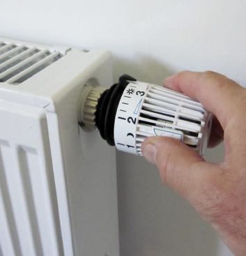

Provides room-by-room zoning. The ability to control heat output on a room-by-room basis has always been a benefit of hydronic heating. This is equally important in low-energy-use buildings, especially those with the potential for significant and unpredictable internal heat gains. Solar gains through generously sized south-facing windows are a good example. There are several ways to implement room-by-room zoning using hydronics. One of the simplest approaches uses wireless thermostatic valves that regulate flow through each heat emitter.

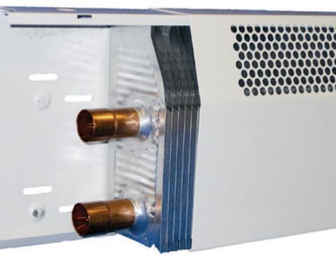

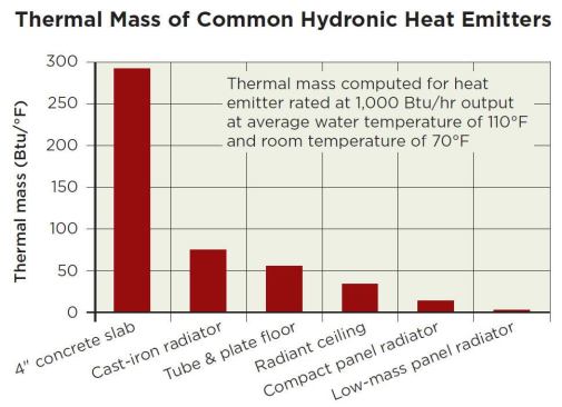

Includes low-mass heat emitters. Energy-efficient houses may be subject to wide temperature variations due to localized thermal gains. To prevent unacceptable temperature swings, it’s necessary to quickly stop heat emission when the desired comfort condition is achieved. One of the criticisms of radiant floor heating – especially those systems where tubing is embedded in slabs – is that it cannot respond fast enough to temperature swings. Low-mass heat emitters, like the panel radiator shown, can react much faster and thus reduce temperature variations.
These masses are based on the amount of heat emitter required to release 1,000 Btu/hr at a supply water temperature of 110°F. Notice that the micro-fan-enhanced low-mass panel radiator has less than one percent of the thermal mass of a 4-inch-thick heated floor slab.

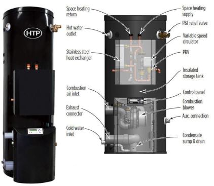

Some heat sources are now available that restore the desirable self-buffering characteristic. One example is the Versa-Hydro combined heating appliance from HTP (htproducts.com), which provides both domestic hot-water and space heating. Depending on the model, the tank contains up to 119 gallons of potable water for thermal mass; this mass in turn “communicates” with the space-heating system through a self-contained stainless steel heat exchanger. The Versa-Hydro is ideally suited as the anchor storage component in a hydronic system for a low-load house. It can also be ordered with an internal coil heat exchanger that allows heat input from solar collectors.

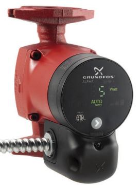

Makes minimal use of distribution energy. A properly designed hydronic system can deliver heat to a building using a fraction of the electrical energy required by a forced-air system. In some cases, the wattage required by the circulator is only about 3 percent of that required by a blower motor of similar heat-transport capacity. This is a tremendous advantage, and unfortunately one that’s not often appreciated by those who focus solely on the thermal efficiency of the system’s heat source.
A modern ECM (electronically commutated motor) pressure-regulated circulator can reduce the operating power requirements for a home-run distribution system in a 2,500-square-foot house to less than 30 watts under design load conditions. One example of such a circulator is the Grundfos Alpha. Similar products are also available in North America from Wilo, Bell & Gossett, and Taco.

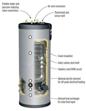

One way to consolidate several of these design characteristics is to build systems around a central thermal-mass unit called a thermal accumulator, like those from Triangle Tube (triangletube.com). From the outside, it looks like a hot-water tank with a few extra connections; inside, though, there’s a lot going on. Under a thick urethane insulation layer is a carbon steel outer tank. The water in this tank can accept heat from a number of external heat sources – a boiler, a heat pump, or solar collectors. It can also accept heat from the internal heat-exchanger coil seen near the bottom of the outer tank. This device can even be ordered with an electric heating element installed in the lower portion of the outer tank, for use during off-peak periods when the price of electrical energy drops significantly. Suspended within the outer tank is a stainless steel inner tank, which holds potable water that’s completely isolated from the water in the outer tank. Thus any heat input to the outer tank can also heat the potable water, assuming the latter is at a cooler temperature. The thermal mass of the water in both tanks provides buffering against short-cycling of the heat source in applications with highly zoned heating distribution systems.
Performance
The thermal accumulator can be used as the anchor component in a system supplying multiple zones of space heating and domestic hot water. Heat is provided by a high-efficiency modulating/condensing boiler and a solar collector array. As mentioned before, space heating is delivered by several panel radiators configured in a home-run distribution system. Flow through this distribution system is provided by an ECM-powered pressure-regulated circulator. Each time one of the thermostatic radiator valves opens, closes, or just adjusts flow rate, the circulator varies speed to maintain a fixed differential pressure across the manifolds.
If the sun is out, solar-derived heat is added to the outer tank through the coiled internal heat exchanger. That heat could contribute to either space heating or domestic water heating. Given ample solar heat gains, water within the thermal accumulator could reach seriously high temperatures of 180°F or more. That’s why there’s an antiscald-rated thermostatic mixing valve on the domestic water supply piping. It’s also why there’s a three-way motorized mixing valve to protect the space-heating system from excessively high water temperatures. When the sun can’t sufficiently heat the tank, the boiler is automatically fired to maintain acceptable domestic hot-water temperature.
