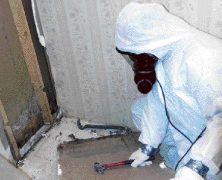

Protective gear. You need to be very strict about personal protection -- you're open to a comp claim or lawsuit if anyone starts to feel sick. The crew should wear masks that meet the N95 disposable respirator standard. These are now widely available at all of the big-box hardware stores for a couple of dollars each. (Don't confuse these with much cheaper "nuisance dust" masks.) The crew should also wear latex gloves and goggles, because some people may get allergic skin reactions to the many substances molds produce.

Containment. Disturbing moldy materials can greatly increase the levels of spores and contaminated dust in the air. Contaminated materials must not be allowed to spread beyond the work area. The key to preventing this is something called containment -- essentially a matter of isolating the work area with overlapping sheets of plastic that are sealed at their edges. Containment is not required for small moldy areas under 10 square feet but is recommended for areas between 10 and 30 square feet.
I recommend that containment with plastic be employed on all cleanup or demolition jobs. It's cheap and effective. At this level, there's no need to create a negative pressure field by exhausting the air from the work area through a HEPA filtration unit. That's not a bad idea, but the guidelines don't direct you to do it.
To depressurize the workspace on small jobs, I sometimes buy an inexpensive box fan and a 1-inch pleated-media filter (such as a 3M Filtrete filter) the same size as the fan. I tape the filter to the fan and seal the fan in the window, creating a simple exhaust system with a filter that will easily capture mold spores. The air is drawn from the house, pulled through the contaminated work area, then filtered and exhausted to the outside.
In any case, do what you can to suppress dust during your work. One effective way is to mist the areas before cutting into them. You don't want to soak them, just dampen them enough that you don't stir up a cloud when you work.
