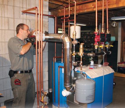

My clients’ 2,100-square-foot home was typical of those built in this area in the 1980s, with 2×4 walls, clear insulated glass windows, and moderate levels of insulation in the walls and attic. In new construction, I’d normally use ACCA (Air Conditioning Contractors of America) Manual J to calculate heat loss and size the boiler. But for this home, the largest 116,000-Btu version of the G 125 BE boiler closely matched the size of the existing Tarm wood/oil boiler. Since I knew the owners might add on to the house in the future, downsizing didn’t make sense.

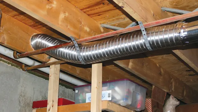

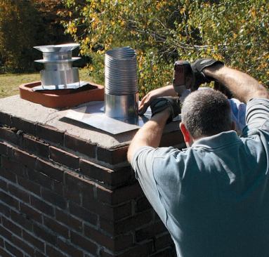

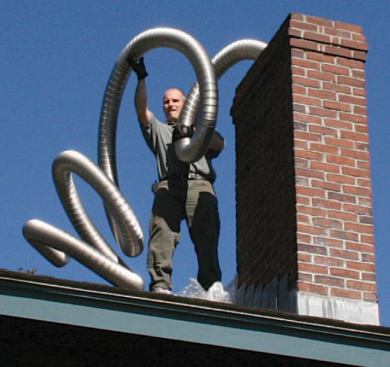

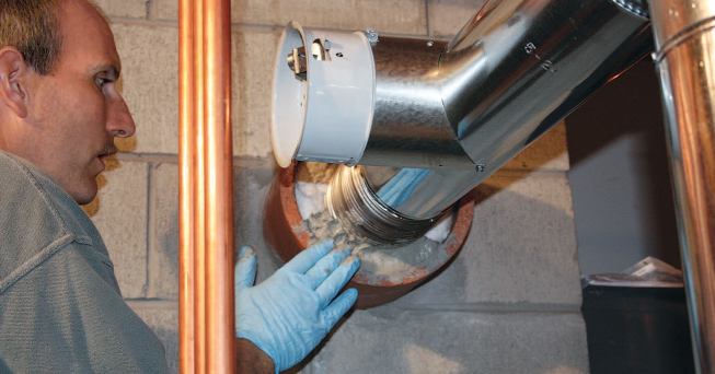

Flue requirements. The noncondensing Buderus boiler can be vented directly to a lined masonry chimney with a correctly sized flue. But because the existing chimney flue was oversized, we installed a 5-inch-diameter stainless steel chimney liner to guarantee a good draft and avoid potential corrosion problems from any flue gases condensing inside the chimney. Installing the liner accounted for about $1,300 of the project’s overall cost. To help ensure proper draft, the exhaust flue is fitted with a barometric damper.

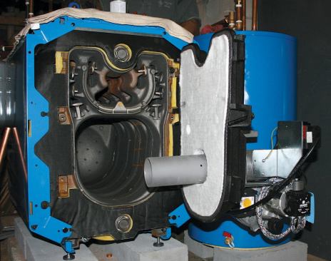

Higher efficiency, lower emissions. Even though the Buderus is a new boiler in the U.S., we’re comfortable recommending it because of its 10-year track record in Europe, where fuel costs are high and emissions standards are stringent. It’s equipped with a low-NOx (nitrogen oxide) burner designed to operate at a lower temperature than conventional burners, and features a ceramic burner tube in the combustion chamber. As it heats up during combustion, the burner tube recirculates flue gases through the burner until the vaporized fuel is completely consumed, leading to improved fuel efficiency and a decrease in smog-producing NOx emissions.
After the initial burn, the 800°F flue gases exiting the burner tube and combustion chamber make two additional passes through the center of the boiler. By the time the gases exit the rear of the boiler, baffle plates have slowed them down and cooled them to around 300°F. The smooth-wall design of the heat exchanger makes this boiler very easy to clean.

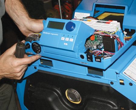

Modulating control. In most conventional boilers, a simple aquastat turns on the boiler when there’s a call for heat or hot water. That causes the burner to fire until the boiler’s internal temperature reaches 180°F, regardless of the season or weather. But the Buderus boiler has a remote sensor integrated with an electronic controller, which takes outdoor temperatures into account when regulating the temperature of the boiler water.
In moderate conditions, when the boiler doesn’t need to heat 6 or 7 gallons of water all the way up to 180°F to maintain the house at a comfortable temperature, the boiler may stop firing at only 130°F or 140°F. The Logamatic controller, as Buderus calls it, also manages the system’s new indirect domestic hot-water tank. If my clients ever decide to upgrade, the controller can integrate solar panels or radiant heating into the system, too.

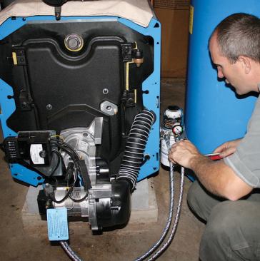

Bubbles and heavies. In addition to the standard tank prefilter, which catches most of the heavy particles in the fuel, the boiler comes equipped with a Tigerloop deaerator (beckettcorp.com). The deaeator has a secondary 10-micron filter that removes tiny air and gas bubbles that can interfere with combustion. There’s also a fuel-line preheater, basically a low-wattage resistance element that briefly turns on when there’s an initial call for heat, warming oil in the nozzle line. The burner operates more efficiently because it’s using warm, clean oil instead of cold or dirty oil.

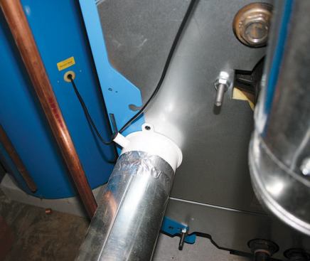

Bringing in outside air. Although Buderus recommends an outside air source for the G 125 BE, it’s not strictly required. Given the age and construction of the home we were working in, it would not have been unreasonable to draw combustion air from inside the living space and count on air leaks in the building envelope to provide makeup air. But doing so would have been short-sighted: If the homeowner (or a future owner) were to significantly tighten things up at a later date, the boiler could find itself starved for air.

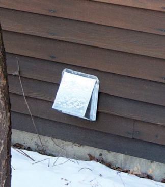

With that scenario in mind, we installed a combustion air system using a screened intake air hood from Field Controls (fieldcontrols.com) and 4-inch-diameter 30-gauge galvanized steel pipe. The pipe connects to a termination collar on the back of the boiler. Buderus has specific clearance guidelines for the wall termination, but the basic rule of thumb is not to place it facing the prevailing wind (though with vertical rather than sidewall venting, this isn’t as critical).
Cold air can cause some burners to operate at less than maximum efficiency, so many boilers require tempered combustion air. But because of the design of the low-NOx burner, this makeup air system doesn’t require the vacuum relief valve we usually install to provide it. Valves are typically located as close to the wall termination as possible but inside the conditioned space, and they open partway in very cold conditions, allowing warm inside air to mix with cold outside air. If the wall termination gets blocked for any reason, the valve allows the boiler to draw combustion air completely from inside the basement. Since this system doesn’t have that valve, we made it a point to remind the homeowner to keep the intake air hood clear of drifting snow.

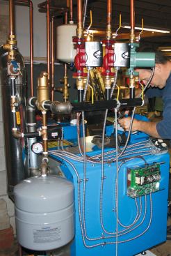

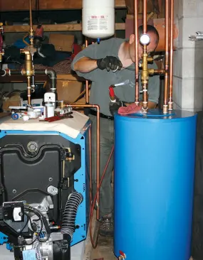

Because the Buderus boiler hasn’t been in operation for a complete heating season yet, it’s hard to predict how my clients’ energy bills will compare with the ones they had under their old system. The old boiler had a tankless coil for domestic hot water — which is an energy hog during the warm months — so we replaced it with a new indirect-fired DHW tank. While we were at it, we also replaced the circulator pump, zone valves, and expansion tanks.
